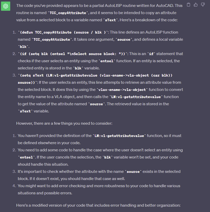

Welcome, One thing chatgpt is good for is learning how to code. You can give it snippets and it will then start to explain whats going on. You can also ask it follow up questions, to explain in more detail, or about a specific part of the code. Just keep in mind what its telling you can be wrong. People end up thinking that all you will need to do is feed it 2 or 3 sentences and get 100% complete working code. and for simple things that can be true but for the most part it isn't there yet.
