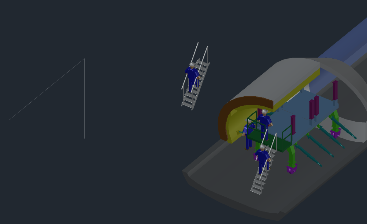

after crashing, autocad recovered the drawing, but it's as if I were in refedit and it's all blacked out,
but that's not the case since I can modify everything, if I draw a line it's not white but grey!
i have ACAD 2023
i attached my dwg
XXXX.dwg
It appears to be a result of the visual style. I changed to 2D wireframe, 3D wireframe, Realistic, etc. and it all turned the gray to white.
It must be on shades of gray, I didn't check to see the original.
