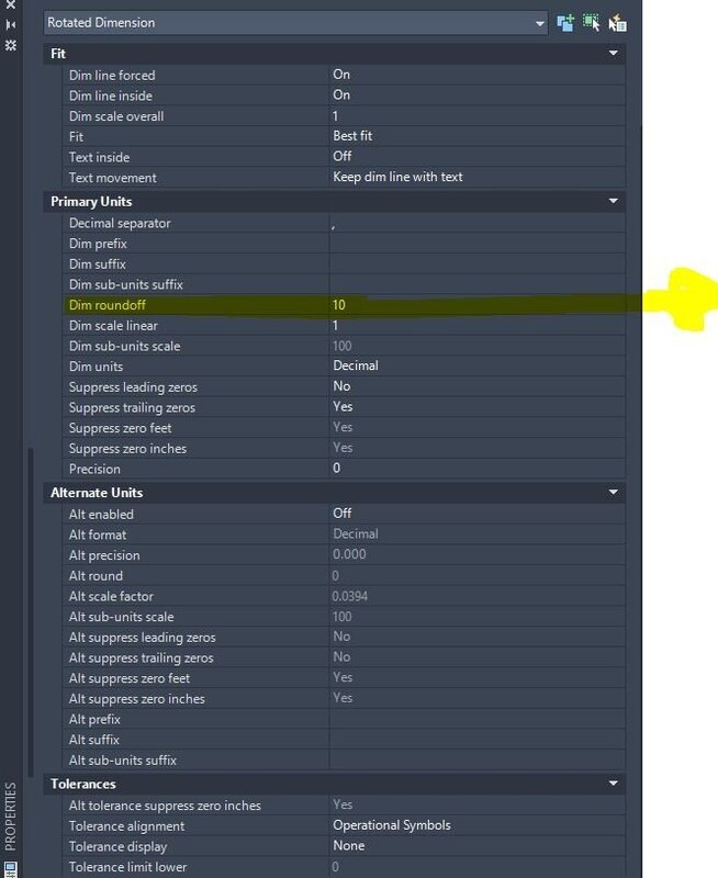

Hello experts.
I'm having problems with the lisp I'm using. Specifically:
- When I set dim style > round off = 10 the lisp I am using still reports the dim values with round off = 0.
Can experts help me fix this error?
Thank you very much !
ccd.lsp Copy dim.dwg
Like this?
