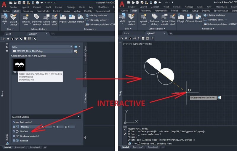

Hello everybody,
I would like to ask you for a help. I am programming some Ribbon menu structure for electrical blocks and lines incl. multilines, multitexts. At the moment I am solving the following problem with the INSERT block VBA statement (only VBA programming, no knowledge with others).
There si some code for insterting block (standard):

varInsertionPoint = ThisDrawing.Utility.GetPoint(, "Vyber umístění")

dblRotation = ThisDrawing.Utility.GetAngle(varInsertionPoint, "Vyber úhel")
'zadat manuálně úhel / není interaktivní
Set objBlockRef = ThisDrawing.ModelSpace.InsertBlock(varInsertionPoint, strName, dblX, dblY, dblZ, dblRotation)
End Sub
This code works fine, but it is not interactive for rotating an existing block (dwg file) on the screen (see figure 1 and see figure 2 interactive from the insert block manually dialog). Are there any VBA or LSP code sequences or other alternative for instert block dialog with parameters to change automatically?
Thanks so much for your feedback in advance.
BR, Jaroslav

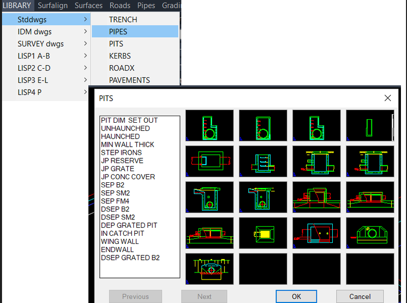

Using a menu to insert a block choose block, choose point then can DRAG the angle
^c^cINSERT ca3ch-1 DRAG \1;;DRAG
From a program prospective a couple of ways insert the block then invoke rotation of the last object, yes 2 steps. But the user wont see it.
Another is pick insertion point then ask for a second point in lisp (getpoint pt1 "\nSelect angle ") this draws a dummy line from the insertion point as you search the screen for angle, you then get angle pt1-pt2. But you do not see block.
