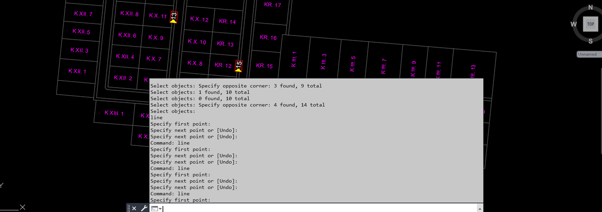

I have tried with the lisp that you have provided, the results still do not change.

I want to create lines or polylines at once, from the same object to different destinations

I have followed the command prompt instructions, and the result is that nothing happens

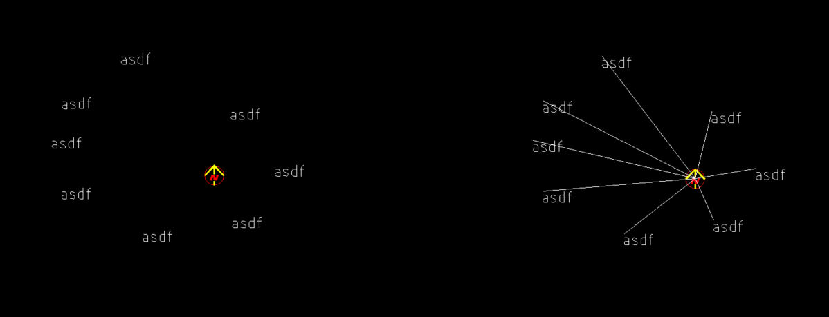

Not sure what is wrong, before after
Maybe something to do with your block post a sample dwg.

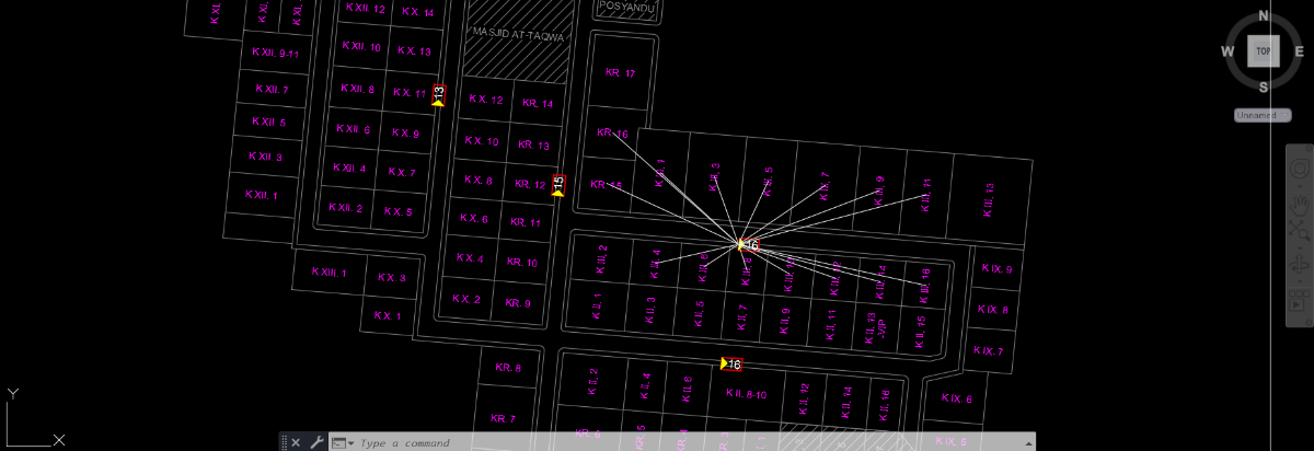

it's solved

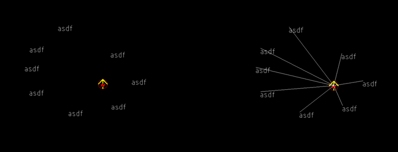

You are so amazing. thank you for helping me. its work 🙏

if i want to change from block to all object, how to change the lisp. 🥹
You could just pick a point.
; (setq blk (entsel "\npick block "))
(setq inspt (getpoint "\nPick point for end of lines. "))

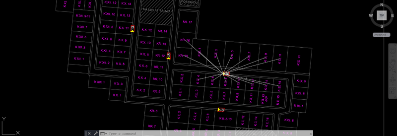

; 1L - 2023.10.05 exceeds
; draw lines from selected objects to 1 point.
(defun c:1L (/ *error* acdoc ss ssl pt1 index ent pt2 line)
  (setq acdoc (vla-get-activedocument (vlax-get-acad-object)))
  (defun *error* (msg)
    (vla-endundomark acdoc)

This is what I use.
It can be used with manual selection set,
but it is also good for remembering the selection set
after [Find > SelectAll] or [QSELECT] something.
