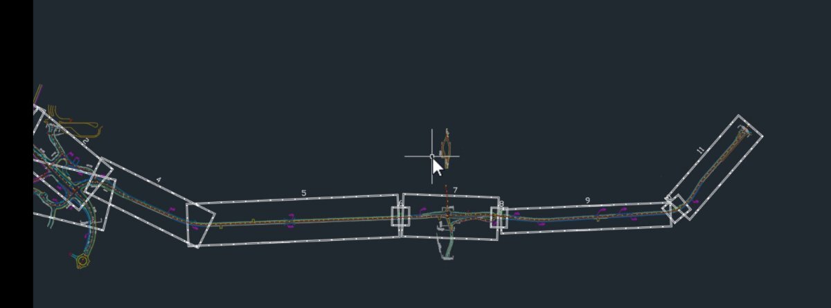

alat Posted September 28, 2023 Posted September 28, 2023 hi, i am looking for a lisp that can generate a paper size according to the layout i created (with scale i chose). i use many size of layout sizes, and i dont want to create manualy a new custom paper size each time. the lisp will identify the size i need and will create one. is there a lisp close to this description? Quote

alat Posted September 28, 2023 Author Posted September 28, 2023 (edited) Quote Do you not have fixed paper sizes ? eg A1 A2 A3 A4 24x36 24x18. Expand no, i create different size each time. the way i make the layout: i create a rectangle and than a lisp create me a layout of this polygon with the scale i choose. i dont even know what size the layout size is. so when i create the paper size is trial and error. Edited September 28, 2023 by alat Quote

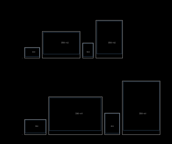

BIGAL Posted September 29, 2023 Posted September 29, 2023 We always work as suggested here to say a Client request size so when they print them it looks right. Yes can do the scale of sheet. Why not just have a block or another dwg with your sheets in it at true scale so can drag over your dwg and make a more educated guess. Quote

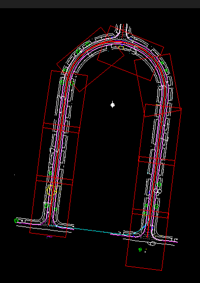

alat Posted September 29, 2023 Author Posted September 29, 2023 (edited) You can see here the differences between the rectangles. Each rectangle is for different team of workers. I can't use regular sizes Edited September 29, 2023 by alat 1 Quote
BIGAL Posted September 30, 2023 Posted September 30, 2023 That looks like road works, and yes that is what I have done most of my life and there is no way that I would be doing it like that, or my old team 6 road designers. Your plans would have been rejected. Yes can do autolayouts and they are at correct size for a given scale of sheet, yes can do the little detail rectangs as well. Follow a pline. Quote
