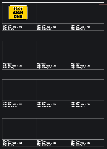

I have managed to make something which lists the signs and the quantities
but im wondering if i would be a able to take it a step further style the list/s like:
if there is more than 12 individual signs, create a new table to the right of it, im sure i can sort the text part of this and adding in the block to the table, my only issue/worry is trying to style the table to this format and how i would then make it create a new new one if there is more than 12
i have attached the DWG file for reference

Ok now the problem, you need a big look up list as hinted you can have some signs in more than 1 size. Hidden attributes would help you can save the size and type, just set attributes to invisible, but they are there for block counting. A sort of blocks using a list of (name size type.... and so can count the same sign but different sizes.
One way around the getting table correct is to do just that and make a custom table in your code checking does it exist. That way all settings are correct.
Before everybody jumps in really need you to supply a couple of real block examples, it is very frustrating to have like 5 goes at code because true block names are not there. Really need attributes also or else how know size ?
The block names seem odd any reason for that rather than like "STOP" "Warning1" yes I have access to hundreds of signs in some other software.
