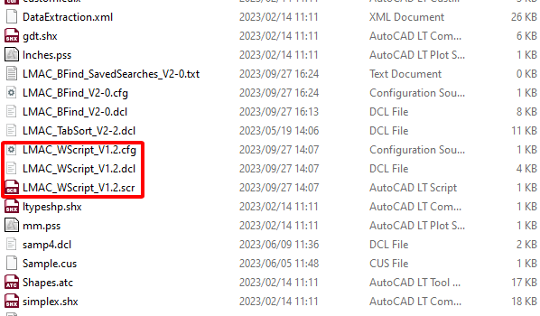

Hi All, I've started using the AutoCAD LT 2024. As I had a limited access to full CAD only, I was using rather simple scripts which work on LT, but for some repetitive tasks I used to use Lee Mac's Script Writer 1.2. So now, I would like to try this lisp with the LT version.
Sadly unsuccessfully... When trying to choose the folder by clicking on "Directory" button the whole script crashed with info about "Automation Error. No Description provided"... Do you have any idea what could be causing this? And is there a chance to fix it or LT still has some limitations, so the lisp simply won't work? At the moment I have access neither to full CAD nor to the Visual LISP Editor to debug the code...
WScript generally works, however when you run it the first time, it added extra backslashes to the path, like "C:\\Users\\name\\Documents\\". This causes an error, because it creates a wrong path in the script file (.scr) with double backslashes before the file name. But changing the path manually in a config file (without these end backslashes)... it works like a charm ;)
I also noticed that DOS Library (DOSLib24x64) cannot be loaded into LT 2024, so in script where DOSLib functions are used, they had to be changed to AutoLISP ones, like "dos_delete" to "vl-file-delete". But Lee's script is so complex (at least for me), so I was not able to find and fix the error. Any advice?
The issue is because the LISP API in AutoCAD LT cannot interface with ActiveX objects outside of the AutoCAD object model (in this case, the Windows Shell Object, used to display the 'Browse for Folder' dialog).
I could redesign the Script Writer program to allow the user to select a drawing within the folder to be processed (using a standard file selection dialog, thus compatible on LT), but to be honest, given the age of the application and the other bugs present in some of the features, the entire program really needs to be rewritten.

Thanks Lee Mac for the response. Yes, it's quite old stuff, but still does the job. I will think about using the standard file selection or simply change the dialog box to manually add the path. As I said, because the dialog box read the config file prior to open I can also change the folder in this text file...

C:\XXX\XXX\AppData\Roaming\Autodesk\AutoCAD LT 2024\R30\enu\Support
That would surprise me if you needed to delete a file to make it all work - Lee Mac is usually very good with things like that. If the OP has only just downloaded the LISP then these files should be all up to date.
