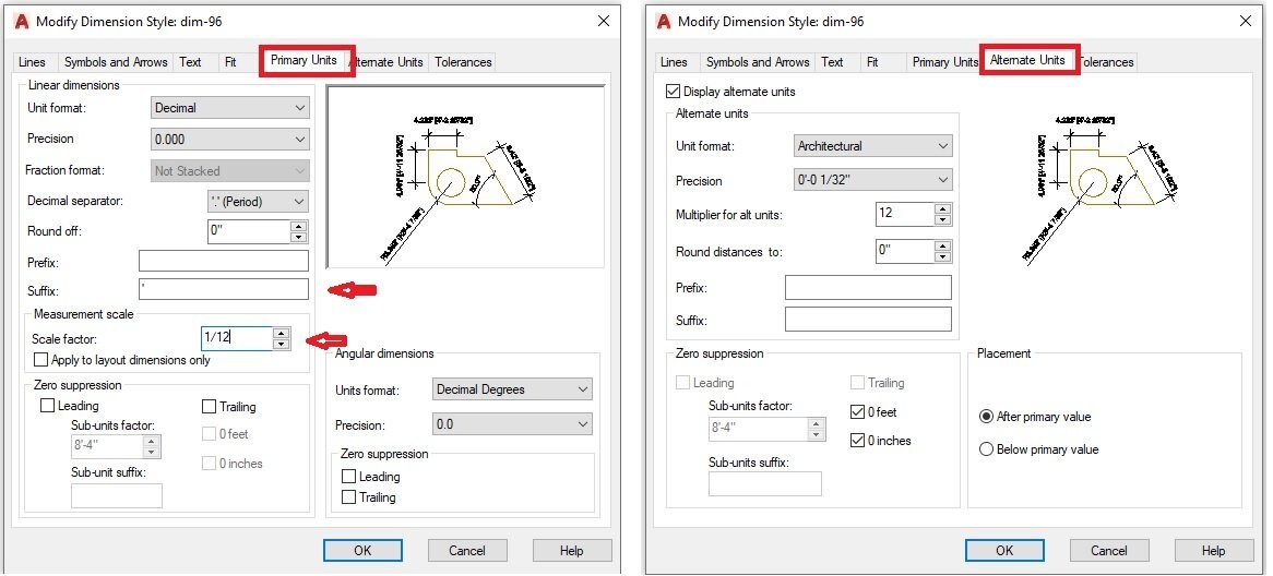

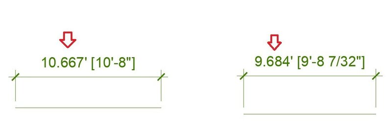

Ogopogo Posted October 6, 2023 Author Posted October 6, 2023 Hi Fuccaro, You're amazing! It works! Thank you very much for helping me on my request. Fuccaro & Bigal Regarding the Feet-Decimal, I have attached 2 screens shots. The first screenshot is setting up the units in Primary and Alternate Units. In the Primary Unit: selected "Decimal", selected "0.000", selected "Period", typed in "apostrophe ( ' )" in the suffix and enter "1/12" in the scale factor. In the Alternate Unit: selected "Architectural", precision "1/32" and multiplier "12". The second screenshot shows both primary and alternate dimension. The first dimension is the "Feet-Decimal", the one I was asking about and wondering it is possible insert into the block. Quote
