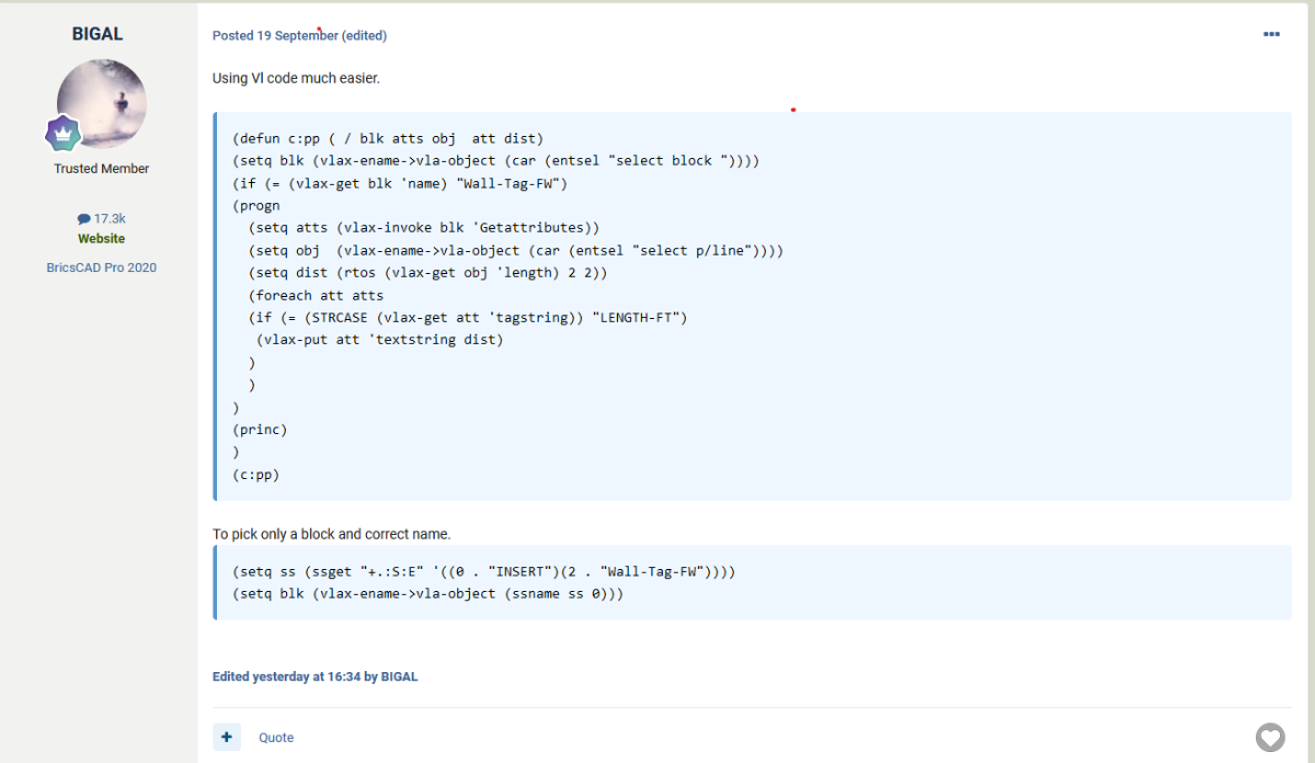

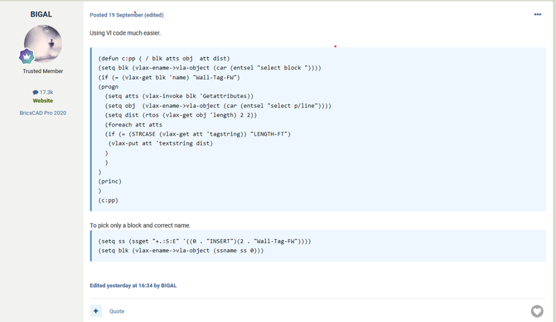

BIGAL Posted September 19, 2023 Posted September 19, 2023 (edited) Using Vl code much easier. (defun c:pp ( / blk atts obj att dist) (setq blk (vlax-ename->vla-object (car (entsel "select block ")))) (if (= (vlax-get blk 'name) "Wall-Tag-FW") (progn (setq atts (vlax-invoke blk 'Getattributes)) (setq obj (vlax-ename->vla-object (car (entsel "select p/line")))) (setq dist (rtos (vlax-get obj 'length) 2 2)) (foreach att atts (if (= (STRCASE (vlax-get att 'tagstring)) "LENGTH-FT") (vlax-put att 'textstring dist) ) ) ) ) (princ) ) (c:pp) To pick only a block and correct name. (setq ss (ssget "+.:S:E" '((0 . "INSERT")(2 . "Wall-Tag-FW")))) (setq blk (vlax-ename->vla-object (ssname ss 0))) Edited September 27, 2023 by BIGAL Quote

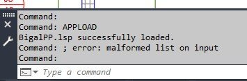

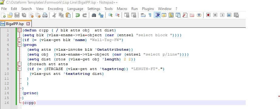

Ogopogo Posted September 23, 2023 Author Posted September 23, 2023 Thank you Fuccaro & Bigal for advising me to use Notepad not Wordpad. I have installed Notepad ++. Starting from scratch, I have copied and pasted both codes. Fuccaro's lisp works great. However, Bigal's code isn't working. I have saved Bigal's code as "BigalPP.lsp", see "Screenshot 2023-09-23.jpg". In Autocad, I loaded the lisp file using "Appload", but receive an error message, see "Screenshot 2023-09-23-1.jpg". I wonder if it is ""LENGTH-FT".", is causing the error.? I have very limited knowledge on Autolisp programming. Once again, I thank you both for helping me. Quote

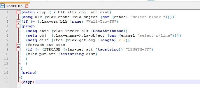

BIGAL Posted September 23, 2023 Posted September 23, 2023 (edited) Sorry my fault a typo did not see it crept in somehow when testing Look at your IF line 9 has a extra " and "." Should be (if (= (STRCASE (vlax-get att 'tagstring)) "LENGTH-FT") Edited September 23, 2023 by BIGAL Quote
Ogopogo Posted September 24, 2023 Author Posted September 24, 2023 Hi Bigal, I have taken out the period "." by coping and pasting your code, see screen shot 2023-09-23-2. I uploaded the revised "BigalPP.lsp" by "Appload", however there is a different error message "; error: malformed list on input", see screen shot 203-09-23-03. I'm sorry for the many texts. Quote
BIGAL Posted September 24, 2023 Posted September 24, 2023 Sorry do apologies again I should have looked closer code updated missing a ). Quote
Ogopogo Posted September 25, 2023 Author Posted September 25, 2023 No worries Bigal, I'll wait for your revise code for the missing a). Quote
Ogopogo Posted September 26, 2023 Author Posted September 26, 2023 Hi Bigal, I have copied and pasted the updated code, see below. However, I'm still getting "error: malformed list on input" when I load the lisp file. Is what I copied and pasted the correct code? My apologies, if I'm not correctly following your instructions. Quote
BIGAL Posted September 27, 2023 Posted September 27, 2023 (edited) When you post a request like this in future always post a dwg, a problem can be as simple as Capitals in the block name. I have to dummy up a dwg block to test code. Download code again Edited September 27, 2023 by BIGAL Quote
Ogopogo Posted September 27, 2023 Author Posted September 27, 2023 Hi Bigal, Big high 5! Thank you very much it works! Adding another ) above (princ) did the trick. Quote
