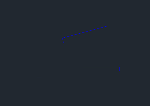

I have a lot of polylines  like the ones in the picture.
I wan to mirror all of them on the longest side of the polyline like the following picture.
Does anyone have a lisp like that ?
