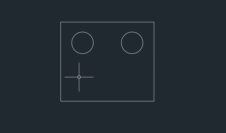

In our plate example, you’d start with Add Area, then its Object option, and select the outer boundary of the plate. Without exiting the command, select the Subtract Area option and Object again. Now, select the hole. You’ll see the dynamic area and perimeter display update to remove the hole from the plate. Do it again to remove them both.
Add and subtract area in AutoCAD
