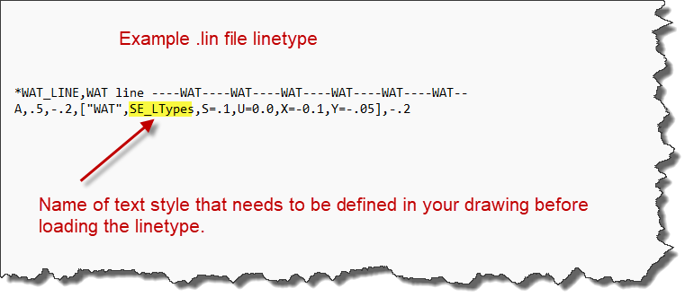

Most of the time I get linetype loading errors in drawings it is because the linetype I am loading uses text in it like a water line ----WAT----
but the text style that the linetype is using is not defined in the drawing.
Open the .lin file and make sure that you have a text style with that name in your drawing.
Also - make sure that the text style is NOT annotative or that it does NOT have a height defined to it. It should have a text height of zero. This way, the size can be controlled by the linetype definition and scale.
