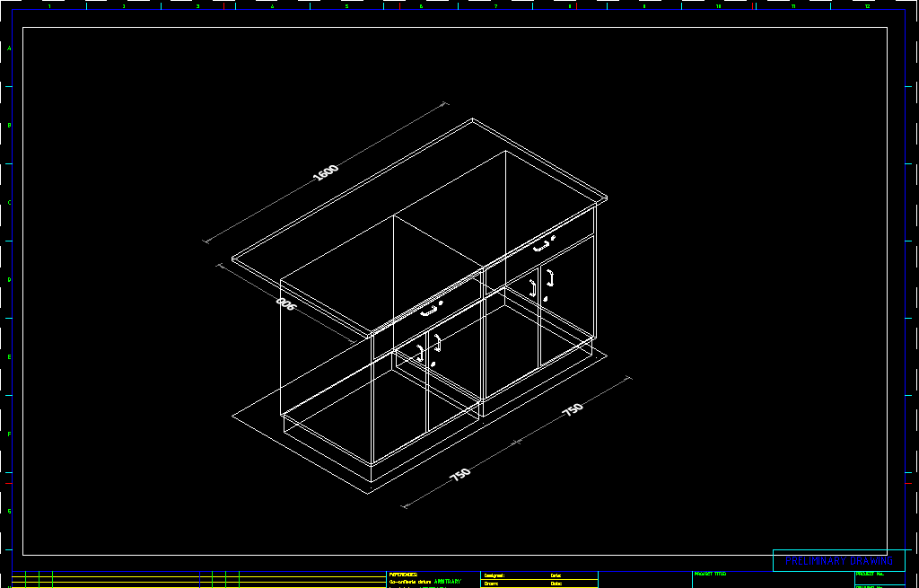

Sekar Posted September 10, 2023 Share Posted September 10, 2023 Hi., i have nearly 20 drawings done in the 3d space (in model), each drawings are bounded by a 2d rectangle. i would like to place the each drawings in individual layout. i have inital layout named "1" with all the pagesetup has been applied & viewport settings are set to legacy hidden. Like to have a script such that each drawings are placed in the layout automatically with the pagesetup and viewport settings predefined. Thanks Quote Link to comment Share on other sites More sharing options...

Sekar Posted September 11, 2023 Author Share Posted September 11, 2023 hi @BIGAL @Steven P Thanks for your inputs, here is the sample file attached. i tried the above code provded by steven, but the selected rectangle doesnot fit in the viewport. can you help on this. 6 hours ago, Steven P said: double click in the layout which means clicking the view port right?, it enters the model space. but after selecting the rectangle another area has been zoomed, which is away from the drawing. am i doing correct or making mistake somewhere. @BIGAL 1 hour ago, BIGAL said: another question you say 3d parts so do the sheets need to imply you want 3d views Front, right etc could be added to the make mview. I do rotation now I guess vpoint could be added. no, refere the drawing, just as it is i want to display. isometric Sample.dwg Quote Link to comment Share on other sites More sharing options...

BIGAL Posted September 11, 2023 Share Posted September 11, 2023 Ok starting to unravel the request the dwg put me off for a little while, so went back to basics, UCS W PLAN this shows the 3dobjects in plan view, should be able to just pick approx centre of objects, then make a layout, using the point and vpoint, can set the objects to centre of viewport. Need the set scale of viewport based on a 3d view say fill viewport then scale say 0.9 as a nice fit. Yes can get the outer box of the objects, thanks to Lee-mac. There are 4 view directions that is actually the easy part. Vpoint -1,-1,1 gives 3d front view. need to think more have something similar for houses. 1 Quote Link to comment Share on other sites More sharing options...
BIGAL Posted September 11, 2023 Share Posted September 11, 2023 (edited) This is just a start to prove concept lots more to do. Based on supplied dwg. Ok for it to work rename Ph01 to Ph00, unlock viewport, delete all existing layouts as we are going to make new ones. UCS W PLAN so model space is in world Load code it should auto run. Just zoom in and pick a central point on your cabinets, each time you pick it will make a layout with a fixed for moment view angle. next version has choices. Keep picking a point inside objects new layouts will be made. Yes lots of stuff to still do. I made like 10 layouts as fast as I could pick a point. Need to think about scale factor so looks as a fit in viewport. (defun wow ( ) (setvar 'ctab "Model") (setq x (- (getint "\Enter start number "))) (while (setq pt (getpoint "\nSelect a point Enter to exit")) (setq tabn (strcat "Ph" (rtos (setq x (1+ x)) 2 0))) (command "layout" "c" "Ph00" tabn) (setvar 'ctab tabn) (command "mspace" "vpoint" "-1,-1,1") (command "zoom" "c" pt 2000) (setvar 'ctab "Model") ) ) (wow) Edited September 11, 2023 by BIGAL 1 Quote Link to comment Share on other sites More sharing options...

Sekar Posted September 12, 2023 Author Share Posted September 12, 2023 (edited) Awesome! :), it works. As the name of the program it is "wow". Thank you very much 2 hours ago, BIGAL said: auto scale to fit in the viewport. Yes more to be added. Like view direction. yes. Edited September 12, 2023 by Sekar Quote Link to comment Share on other sites More sharing options...

BIGAL Posted September 16, 2023 Share Posted September 16, 2023 (edited) Try this a couple of changes, it asks for a direction Front back left right, I may have the view in wrong directions to what you think change in code. Needs Multi radio buttons to be in a support path so autoloads for the directions. Also big thanks to Lee-mac for solid bounding box. You should be in plan view UCS world Plan, select a group of cabinets using window etc. It will make a new layout. Rules layout is called Ph00 and viewport unlocked. Use that one to copy. It will loop and ask for more till you press Enter. I guess could add other views non 3d, Like front back L Side R Side. Yep did those too. (defun c:wow ( / box ss x ent tabn ans) (if (not AH:Butts)(load "Multi radio buttons.lsp")) ; loads the program if not loaded already ;; Selection Set Bounding Box - Lee Mac ;; Returns a list of the lower-left and upper-right WCS coordinates of a ;; rectangular frame bounding all objects in a supplied selection set. ;; sel - [sel] Selection set for which to return bounding box (defun LM:bigbox (selobj / obj spc ) (if (setq box (LM:ssboundingbox selobj)) (progn (setq spc (vlax-get-property (vla-get-activedocument (vlax-get-acad-object)) (if (= 1 (getvar 'cvport)) 'paperspace 'modelspace ) ) ) (if (equal 0.0 (apply '- (mapcar 'caddr box)) 1e-6) (progn (setq obj (vlax-invoke spc 'addlightweightpolyline (apply 'append (mapcar '(lambda ( x ) (mapcar '(lambda ( y ) ((eval y) box)) x)) '( (caar cadar) (caadr cadar) (caadr cadadr) (caar cadadr) ) ) ) ) ) (vla-put-closed obj :vlax-true) (vla-put-elevation obj (caddar box)) ) (apply 'vlax-invoke (vl-list* spc 'addbox (apply 'mapcar (cons '(lambda ( a b ) (/ (+ a b) 2.0)) box)) (apply 'mapcar (cons '- (reverse box))) ) ) ) ) ) (princ) ) (defun LM:ssboundingbox (sel / idx llp ls1 ls2 obj urp) (repeat (setq idx (sslength sel)) (setq obj (vlax-ename->vla-object (ssname sel (setq idx (1- idx))))) (if (and (vlax-method-applicable-p obj 'getboundingbox) (not (vl-catch-all-error-p (vl-catch-all-apply 'vla-getboundingbox (list obj 'llp 'urp)))) ) (setq ls1 (mapcar 'min (vlax-safearray->list llp) (cond (ls1) ((vlax-safearray->list llp)))) ls2 (mapcar 'max (vlax-safearray->list urp) (cond (ls2) ((vlax-safearray->list urp)))) ) ) ) (if (and ls1 ls2) (list ls1 ls2)) ) (setvar 'ctab "Model") (setq x (- (getint "\Enter start number ") 1)) (prompt "select a group of cupboards") (while (setq ss (ssget)) (LM:bigbox ss) (setq ent (entlast)) (setq tabn (strcat "Ph" (rtos (setq x (1+ x)) 2 0))) (command "layout" "c" "Ph00" tabn) (setvar 'ctab tabn) (setq ans (ah:butts 1 "V" '("Chhose 3d direction " "3d Front" "3d Back" "3d Left" "3d Right" "Front" "BacK" "Left" "Right"))) ; ans holds the button picked value as a string (command "Mspace") (cond ((= ans "3d Front")(command "vpoint" "-1,-1,1")) ((= ans "3d Back")(command "vpoint" "1,1,1")) ((= ans "3d Left")(command "vpoint" "1,1,1")) ((= ans "3d Right")(command "vpoint" "1,-1,1")) ((= ans "Front")(command "vpoint" "0,-1,0")) ((= ans "Back")(command "vpoint" "0,1,0")) ((= ans "Left")(command "vpoint" "-1,0,0")) ((= ans "Right")(command "vpoint" "1,0,0")) ) (setq pt1 (car box) pt2 (cadr box)) (setq mp (mapcar '* (mapcar '+ pt1 pt2)'(0.5 0.5 0.5))) (command "zoom" "c" mp 2000) (command "zoom" "OB" ent "") (command "erase" ent "") (command "pspace") (setvar 'ctab "Model") (prompt "select a group of cupboards Enter to exit ") ) ; sort tabs by CAB ;; 07/14/2005 CAB (setq cnt 1 doc (vla-get-activedocument (vlax-get-acad-object)) ) (foreach lay (acad_strlsort (vl-remove "Model" (layoutlist))) (vla-put-taborder (vla-item (vla-get-layouts doc) lay) cnt) (setq cnt (1+ cnt)) ) (princ) ) (c:wow) lastly change the name to something you will remember. Multi radio buttons.lsp Edited September 16, 2023 by BIGAL Quote Link to comment Share on other sites More sharing options...
