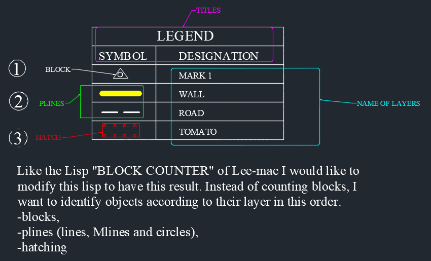

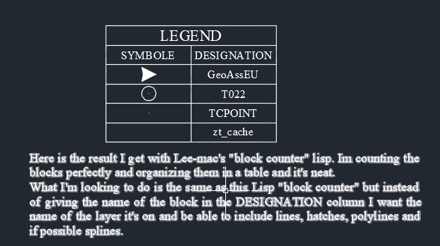

Include Plines in the lisp "block counter" of lee-mac
Hello everyone, I
my name is Roald I am new to the site and to the world of lisps. I recently discovered a very practical and well-made lisp "Block Counter" from Lee-Mac available on his site, this lisp as its name suggests allows you to quickly count the number of blocks in a drawing and present it in a painting. My request on this lisp is how to include polylines. I often need to make legends for my drawings and with this lisp I would like to be able to produce an automatic legend that includes blocks and polylines.
If any of you have any suggestions any help would be greatly appreciated. Sincerely!
I attach said Lisp to the following.

Hello,
it is true that my request resembles that of many maos I bring some details to what I am trying to do like lisp. I would like to modify this lisp to have this result. Instead of counting the blocks, I rather want to identify the objects according to their layer.
-blocks,
-plines (lines, Mlines and circles),
-hatching.

Hi BIGAL, I loaded a lisp but it doesn't work for me. I run the "blkintab" command then I am asked to select the table then I am asked to select the block but when I do so the command stops.
Lee-mac's lisp so I'm talking about in my first and in the title of this post already does this job, he, he identifies me all the blocks in my drawing and classifies them in a table (I put you an image below ).
What I'm looking to do is the same thing as this lisp "block counter" but instead of giving the name of the block in the DESIGNATION column I want the name of the layer where it is located and to be able to include the lines, the hatching , polylines and if possible splines.
