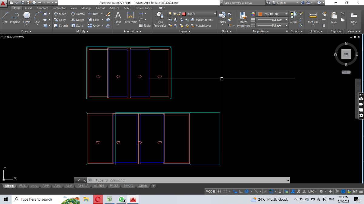

Can anyone help me on completing the creation of a 4 panels sliding door unit.
I have difficulties with the outer frame of the whole unit which I believe may be related to a selection problem and also I am looking for a technique (MOVE or other) to move the sliding sign accordingly.
You help/guidance is most welcomed.
Thanks.
A_SlidingUnit.dwg

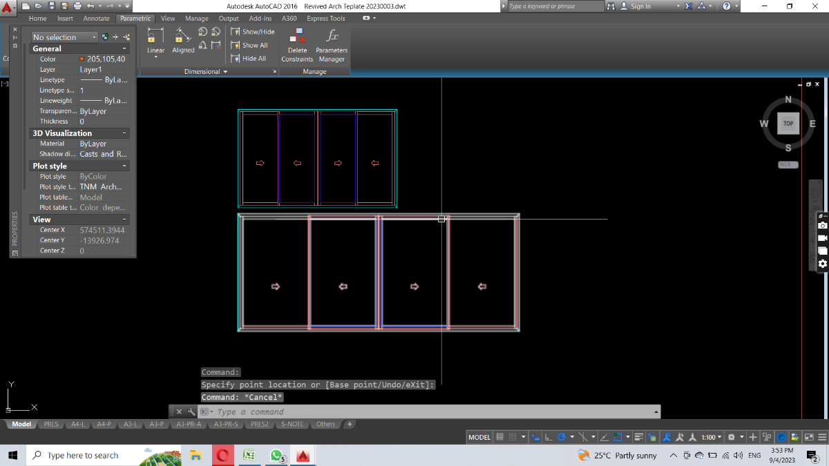

Sorry to disturb. I finally completed the sliding unit with the panel being of equal dimension and the arrow set in the middle.
The problem was that for each of the stretch parameter, the first selection include the frame and the panel but the second one should not include the outer frame. Also for the second selection i did it in two parts the bottom then the top parts as when I did it past the screen some elements were not selected.
I also used moved but with increment 0.125, 1.125+250,0.125+500,0.125+750 that is half the increment used for the intermediary mullion.
I know much more can be done but the main object of creating this sliding unit has been reached.
