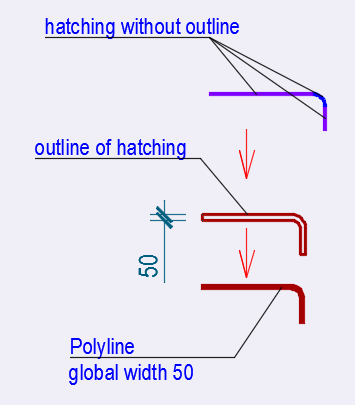

Nikon Posted September 3, 2023 Share Posted September 3, 2023 (edited) Good afternoon. There are many hatches SOLID without a outline, they look like a polyline. Is it possible to programmatically convert the selected hatches into polylines with a given global width (or with a width of 0), or with the ability to specify the width. If this is not feasible, is it possible to convert the outline of a polyline into a polyline with a global width, like a outline (or with a width of 0)? I can use AutoCAD to create a outline for these hatches, but is it possible to do it programmatically: 1 - create outlines for hatches 2 - replace outlines with polylines Lee Mac has a PolyOutline program http://www.lee-mac.com/polyoutline.html This program will create one or more LWPolylines along the boundary of an LWPolyline with varying or constant width. Is the reverse process possible: converting a contour into a polyline? Thank you.Hatching - polyline.dwg Edited September 4, 2023 by Nikon Quote Link to comment Share on other sites More sharing options...

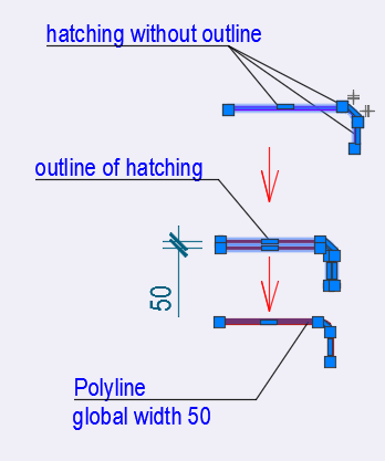

Nikon Posted September 4, 2023 Author Share Posted September 4, 2023 (edited) Probably a bad translation... I need to convert the outline of the hatching into a polyline with a global width. It is necessary that the object has a length... Edited September 4, 2023 by Nikon Quote Link to comment Share on other sites More sharing options...

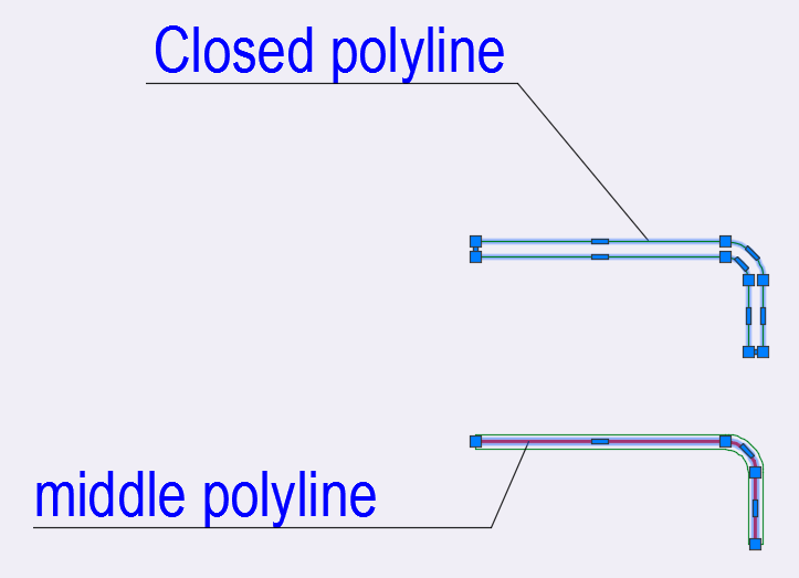

Nikon Posted September 4, 2023 Author Share Posted September 4, 2023 You can simplify the task. Is it possible for a closed outline to build a middle line by selecting this outline? Quote Link to comment Share on other sites More sharing options...

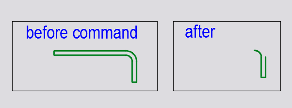

Steven P Posted September 4, 2023 Share Posted September 4, 2023 Try this one: (defun c:testthis ( / MyPoly VertexList SplitHere ) ;;https://www.cadtutor.net/forum/topic/24364-vertices-of-a-polyline/ (defun mAssoc ( key lst / l x ) (foreach x lst (if (= key (car x)) (setq l (cons (cdr x) l)) ) ) (reverse l) ) (setq APoly (car (entsel "Select Polyline"))) (setq MyPoly (entget APoly)) (setq VertexList (massoc 10 MyPOly)) (setq SplitHere (nth (/ (length VertexList) 2) VertexList)) (princ SplitHere) ;; (command "breakatpoint" APOly SplitHere) (command "._break" APOly SplitHere SplitHere) (entdel APoly) ) Quote Link to comment Share on other sites More sharing options...
Nikon Posted September 4, 2023 Author Share Posted September 4, 2023 (edited) command: TESTTHIS Select Polyline(13406.0 5227.07)._break Select an object: The first break point: The second break point: Command: <Object Name: 7ffffb06460> Edited September 4, 2023 by Nikon Quote Link to comment Share on other sites More sharing options...
