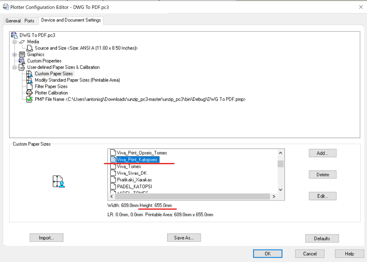

meinfilel Posted August 31, 2023 Posted August 31, 2023 Hello, everyone, I've found the following code online and tried to get the paper sizes I'vw created for my custom printing. I've noticed that for some of the papers the command GetCanonicalMediaNames returns wrong numbers; I mean that when inspecting the paper size from plotter manager you get different number than the one returned by the command. Have anyone else noted this behaviour? For example the paper with name "Viva_Print_Katopseis" is 609x655mm while the code returns its size as 609x860mm. Same with "anagnwstaki_topografiko" (609x846 from printer configuration windows vs. 609x900 from the command). I'm attach my .pc3 file hoping it'll make my problem more clear and easier for you to assist me. Thanks in advance! (setvar 'tilemode 0) (setq AcadObj (vlax-get-Acad-Object)) (setq FilesObj (vla-get-Files (vla-get-Preferences AcadObj))) (setq ActLo (vla-get-ActiveLayout (vla-get-ActiveDocument AcadObj))) (setq ActDoc (vla-get-ActiveDocument (vlax-get-Acad-Object))) (vlax-put ActLo 'ConfigName "DWG to PDF.pc3") ; Plotter Name (setq paperList (mapcar '(lambda (x) (cons (vlax-invoke ActLo 'GetLocaleMediaName x) x)) (vlax-invoke ActLo 'GetCanonicalMediaNames) ) ) my_pc3.zip Quote

meinfilel Posted September 3, 2023 Author Posted September 3, 2023 Thanks for your response. My plots are never standard size (one time i need 860mm the next time 858mm etc) so I want to list all available paper sizes to check if I can select one that exists or I need to make a completely new one. Regarding X and Y, would that cause the difference I noted? Another interesting thing I just found is that when decompressing .pmp (using https://github.com/avbrakel/unzip_pc3) i see this 14{ caps_type=2 name="UserDefinedMetric (609.00 x 860.00MM) localized_name="Viva_Print_Katopseis media_description_name="UserDefinedMetric Portrait 609.00W x 860.00H - (0, 0) x (609, 860) =523740 MM_1_2 media_group=15 landscape_mode=FALSE } but when checking size from plotter I get a different dimension Is there an explanation for that? Thanks again! I'm attaching the decoded txt of my .pmp file. DWG To PDF.pmp.txt Quote
