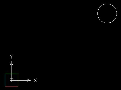

Costinbos77 Posted August 30, 2023 Author Share Posted August 30, 2023 (edited) The below code is working fine in AutoCAD . (setq r (/ (getVar "ViewSize") 80) r- (- r) p '(10 7 0) transL (list (list 1 0. 0. (car p)) (list 0. 1 0. (cadr p)) (list 0. 0. 1 (caddr p)) (list 0. 0. 0. 1.) ) ) (grVecs (list 1 (list r- r-) (list r r-) 2 (list r r-) (list r r) 3 (list r r) (list r- r) 4 (list r- r) (list r- r-) ) transL) But in ZWcad the variable list transL doesn't have any effect . The rectangle is going in origin , no matter where point p is . It is not an oSnap issue . The colored square should be inside of the circle . Any suggestion ? Edited August 30, 2023 by Costinbos77 Quote Link to comment Share on other sites More sharing options...
BIGAL Posted August 31, 2023 Share Posted August 31, 2023 The Grvecs is (list color pt1 pt2 color pt2 pt3 color pt3 pt24 etc. This worked for me. (grVecs (list 1 (list r- r-) (list r r-) 2 (list r r-) (list r r) 3 (list r r) (list r- r) 4 (list r- r) (list r- r-) )) But it is in wrong spot. tansl does not make sense ((1 0.0 0.0 10) (0.0 1 0.0 7) (0.0 0.0 1 0) (0.0 0.0 0.0 1.0)) (setq transl (list 1 (list 7 4) (list 13 4) 2 (list 13 4) (list 13 10) 3 (list 13 10) (list 7 10) 4 (list 7 10) (list 7 4))) (grVecs transl) Quote Link to comment Share on other sites More sharing options...
Costinbos77 Posted August 31, 2023 Author Share Posted August 31, 2023 (edited) Thanks BigAl. 1. But unfortunately , I really need the transL list , because P is not static , it is dynamic , from grRead sequence. I don't put it in my example because I wanted it to be easy & simple one . So , I need the rectangle to move simultaneously with the mouse cursor . 2. I received the ensure from ZWcad , saying grVecs can have a bug . They will check . The below code has the same result as my one . (grVecs (list 1 (list r- r-) (list r r-) 2 (list r r-) (list r r) 3 (list r r) (list r- r) 4 (list r- r) (list r- r-) ) nil) That means is not interpreting my transL list . 3. To avoid all of this , I can use plan B : to calculate myself all 4 corners : (setq c1 (mapcar '+ p (list r- r-)) ) (setq c2 (mapcar '+ p (list r r-)) ) (setq c3 (mapcar '+ p (list r r)) ) (setq c4 (mapcar '+ p (list r- r)) ) (grVecs (list 1 c1 c2 2 c2 c3 3 c3 c4 4 c4 c1) nil) That will work very well in this case . But , this means I need to calculate myself all the time in my other programs when I use the function grVecs with a translation list . Unfortunately , for my oSnap function , grVecs is using : 3 , 4 corners or multiple dots to simulate a circle . In that case , will be a nightmare without a translation list . I hope ZWcad will fix the problem . Edited August 31, 2023 by Costinbos77 Quote Link to comment Share on other sites More sharing options...

exceed Posted September 4, 2023 Share Posted September 4, 2023 (edited) i think, it is true that zwcad has a problem in grvec trans. In zwcad, Lee Mac's GrSnap is also fixed to the origin in the same way and does not work. There are still a few more bugs remaining in zwcad. For example, if user run a Lisp containing LM:ENDUNDO LM:STARTUNDO. sometimes It has to return a flag and escape the while, but it continues to run while infinitely It seems like they only considered simply turning the flag on and off. I think the priorities are weird. this is very critical problem but has not been fixed in 2019, 2022. and acet-, ai-, control a zwcad in VBA, script writer, object DBX... etc. with a little effort, most things are possible in zwcad. but it feels like some screw is missing. I think grvecs is like that too. Edited September 4, 2023 by exceed Quote Link to comment Share on other sites More sharing options...

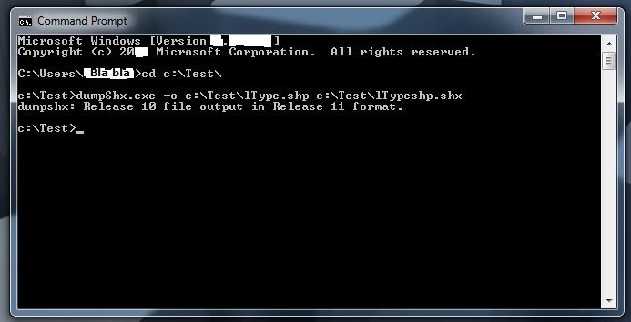

Costinbos77 Posted September 6, 2023 Author Share Posted September 6, 2023 Hi BigAl , Yes, I sent them an email about this . Will see . Great , your links are brilliant ! I didn't know could reverse .shx to .shp . Was very hard to run it , until I found this guide for dumpshx.exe . I will reproduce it below in case the link disappears : 1. Copy file from "C:\Program Files\Autodesk\AutoCAD 20??\Express\dumpShx.exe" to short and easy path "C:\Test\dumpShx.exe" You can even rename the file as "c:\1\d.exe" , TO BE EASY TO WRITE IN the COMMAND PROMPT . 2. Open Command Prompt for Windows , usually by writing in the down-left box . 3. Write to go in your Desired director : cd c:\test\ ; 4. Write all in ONE LINE as : dumpShx.exe -o c:\test\ltypeshp.shp c:\test\ltypeshp.shx and press ENTER . or more easy : dumpShx.exe -o c:\t\2.shp c:\t\1.shx or : dumpShx.exe -o d:\2.shp d:\1.shx and press ENTER . 5. Enjoy ! Picture attached . 1 Quote Link to comment Share on other sites More sharing options...
BIGAL Posted September 7, 2023 Share Posted September 7, 2023 Open Command Prompt for Windows , usually by writing in the down-left box . Just type cmd in the box then enter. Quote Link to comment Share on other sites More sharing options...
