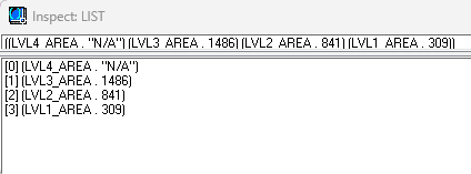

I have my code that creates an association list that looks like this ...((LVL4_AREA . "N/A") (LVL3_AREA . 1486) (LVL2_AREA . 841) (LVL1_AREA . 309))
flrlst is my variable that holds the list, so I am pretty sure I have the code correct to run Lee's code properly.

But now the main issue is that the attribute values in the block are not updating to the values in the dotted pairs.
I know the blocks tags are labeled correctly and when I do an inspect on my flrlst variable I get this.
That all matches up with the block tags.
Any idea what I might be missing? Does order count when using your function? I wouldnt think it does as its looking for the tag to enter the value.
I figured it out.
All the values that are in the dotted pairs need to be Strings.
