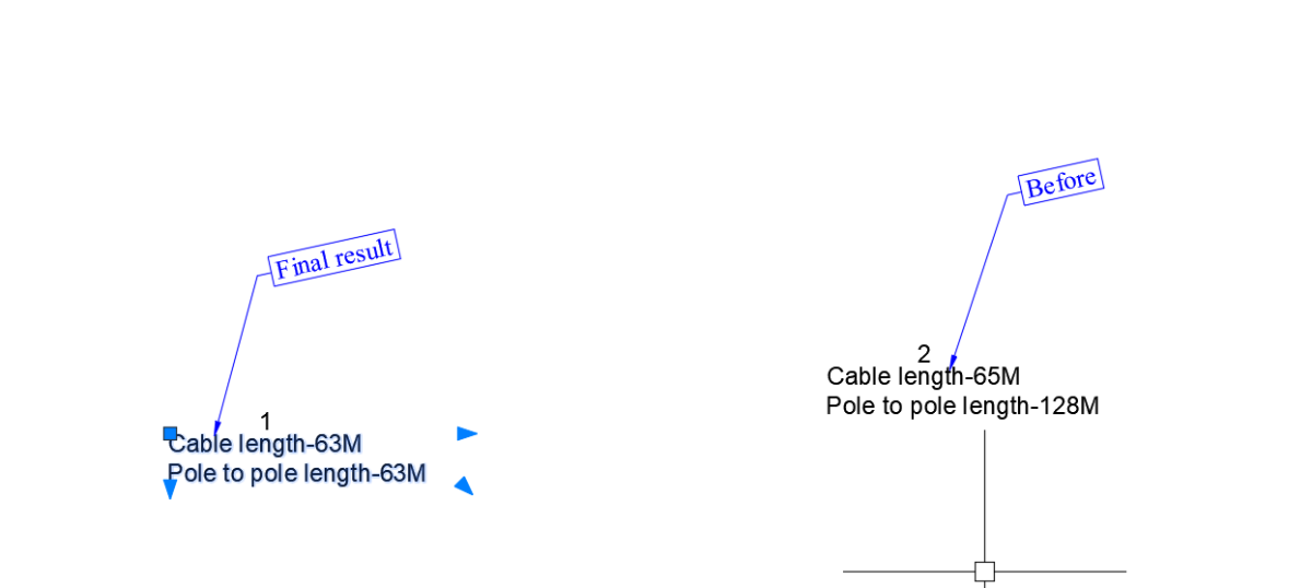

Hi all,
anyone can modify this lisp for me, actually i have 2line mtext and i want to join them as it appears, the lisp i found working only on one text after that i again giving command and joining them is their any way to join all mtext one go and in 2line paragraph like in screenshot and sample file, kindly help me i need this in very shot time.
pole.dwg
JoinMtext.lsp
Edited by pmadhwal7

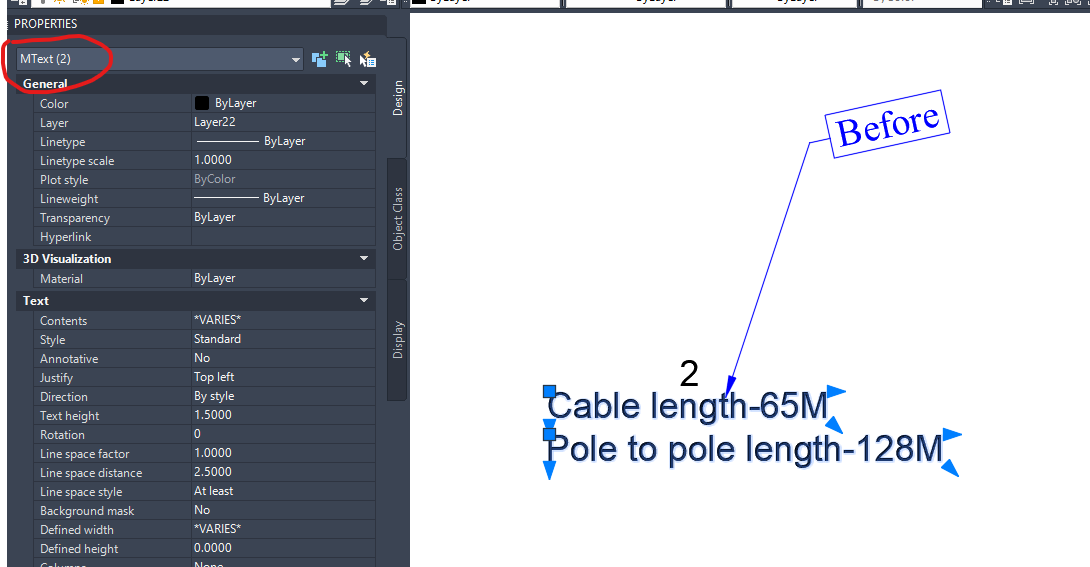

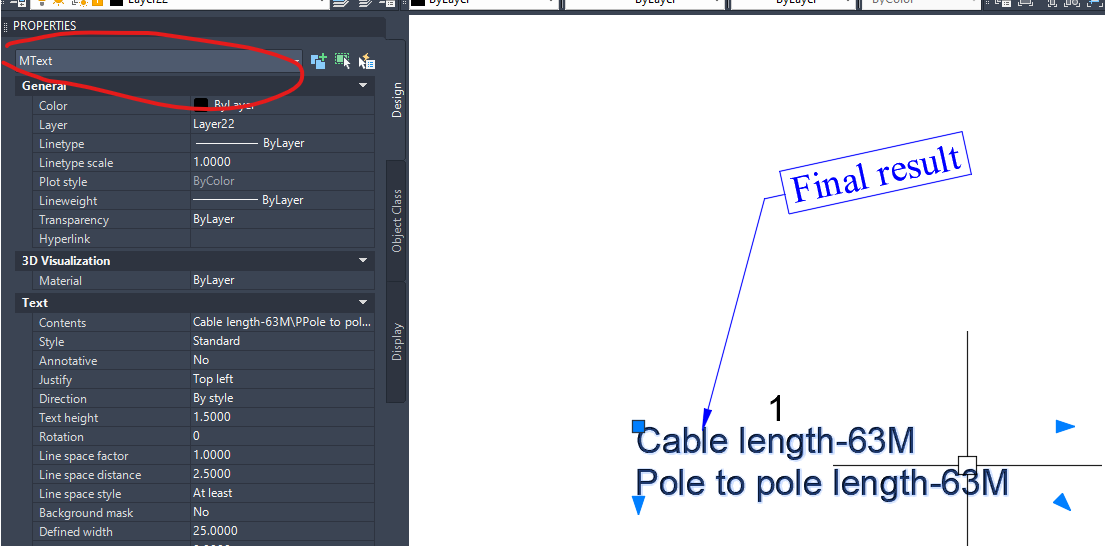

thanks very closed what i want but just one thing actually i want to join Cable length and pole to pole length in on text and this code join both separately, can you modify
13 hours ago, CyberAngel said:
TXT2MTXT has some quirks that I only recently found out about. If you run it without selecting anything, you can access the settings dialog, where you can specify how it runs. There you can specify what order to use when assembling your new mtext. One regrettable feature is that it always changes the justification to top, regardless of the original text.
So you can select your text in the order you want it to appear in the mtext. You can even create a single mtext for each text.
actually i used TXT2MTXT but i didn't get proper result what i want
16 hours ago, Steven P said:
It would be possible to make something up selecting al the 2 line texts and joining them - something like join all the texts where the x coordinates are similar, and you could do a shortcut so you don't need to type txt2mtxt every time (example via LISP (defun ttm ( / ) (command "txt2mtxt")) but you can just make a shortcut up anyway)

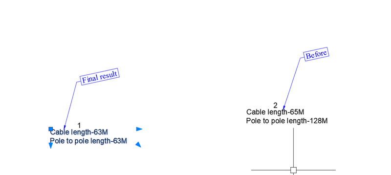

problem is i want 2 line text first is cable length and second is pole to pole and TXT2MTXT not giving me proper result
Can you attach example text
YOU CAN CHECK MY ATTAHCED SAMPLE DWG ALSO AND SCREENSHOT ARE BELOW
Edited by pmadhwal7
Ahh, I think I understand:
Each text selected is on a new line:
Cable Length
Pole to Pole
and not
cable length pole to pole
Pulled apart my textjoin lisp for the below. It might refer to other functions, let me know if it does. It is a bit long winded perhaps but it's parent does other stuff such as attributes and dimensions.
if you want to spend the time it could do with the text selection being checked or an ssget, single selection with a filter for text, mtext.
This will retain the type of text of the first line selected, in your example drawing it is mtexts and so creating mtexts afterwards.

exactly like this but not picking one by one want to join all by selecting them without moving their position, like Mr. hosneyalaa's lisp
13 hours ago, SLW210 said:
Try Kent Cooper's and other LISPs -- Combine Multiple Mtext into 1 Mtext - Autodesk Community - AutoCAD
actually i used this and only negative point for me is the lisp is that join text one by one and in my dwg i have too many text like that and joining them one by one is taking very long time,
