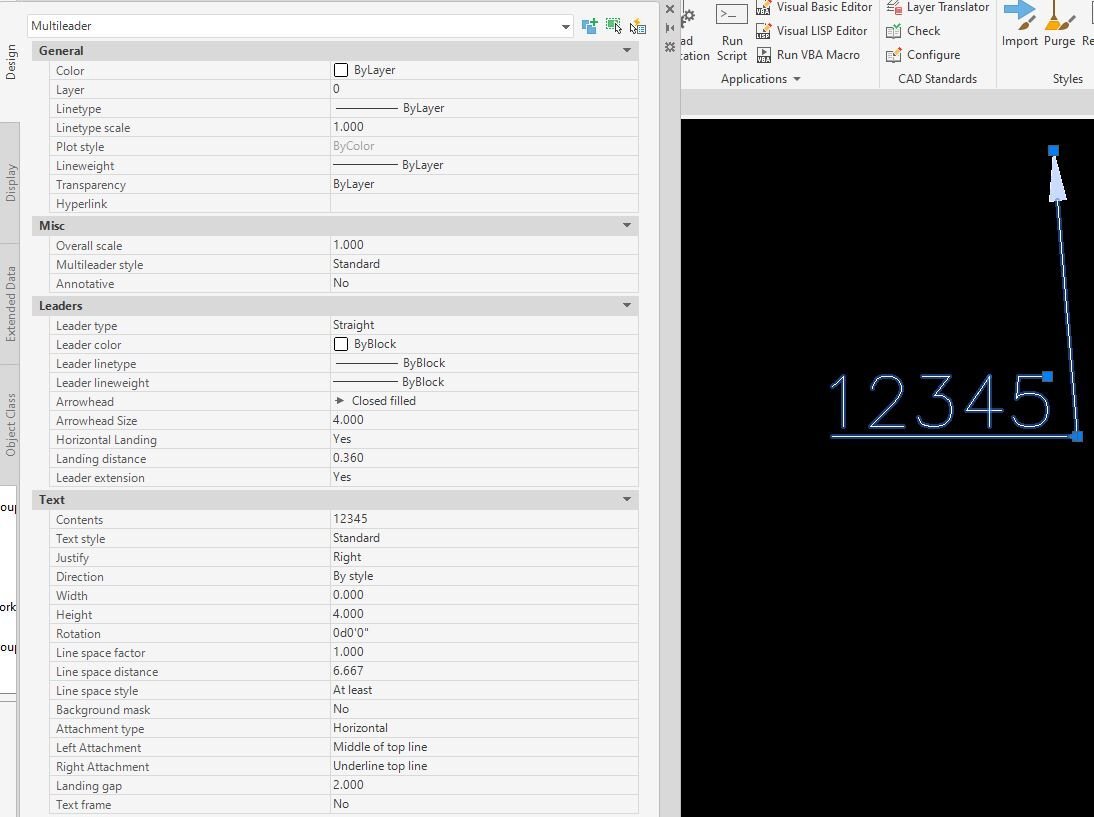

How to vla-get and vla-set the TextAlignmentType prop for MLEADERS?
This is the code that I'm having issues with the TextAlignmentType property is the issue.
How can I vla-get and vla-put it?

Isn't it rather the TextJustify property you want to get instead of TextAlignmentType?

Yes, thanks @hosneyalaa
TextJustify was the one.

          getScaleFactor      (vla-get-ScaleFactor obj)
          getStyle            (vla-get-StyleName obj)
          getTextFrameDisplay (vla-get-TextFrameDisplay obj)
          getTxtBkgFill       (vla-get-TextBackGroundFill obj)
          getTxtJustify       (vla-get-TextJustify obj)
          getTxtRot           (vla-get-TextRotation obj)
          getTxtStr           (vla-get-TextString obj)
          getTxtWidth         (vla-get-TextWidth obj)
          lstpts              (vl-remove-if-not
                                '(lambda (p) (eq (car p) 10))
                                (reverse endata)
          lstptslen           (length lstpts)
          ldxf10_1            (cdr (nth 1 (reverse lstpts)))
          ldxf10_2            (cdr (nth 3 (reverse lstpts)))
          ldxf10_3            (cdr (nth 2 (reverse lstpts)))
          getLeaderCnt        (vla-get-LeaderCount obj)
    ) ;; setq
    (cond
      ((or (> lstptslen 5) (< lstptslen 4))
       (ssadd en sel_mls_not_compat)
      ((or (= lstptslen 5) (= lstptslen 4))
         (if (= lstptslen 5)
           (command "_.MLEADER"
                    "_H"
                    "_L"
                    "_O"
                    "_M"
                    3
                    "_X"
                    "_non"
                    (trans ldxf10_1 0 1)
                    "_non"
                    (trans ldxf10_2 0 1)
                    "_non"
                    (trans ldxf10_3 0 1)
         (if (= lstptslen 4)
                    "_H"
                    "_L"
                    "_O"
                    "_M"
                    2
                    "_X"
                    "_non"
                    "_non"
         (setq entnew (entlast)
               objnew (vlax-ename->vla-object entnew)
         (if en
             (if (/= getTxtWidth 0)
               (vla-put-TextWidth objnew (/ getTxtWidth getScaleFactor)) ;; Testing the dividing the text width by the scale factor of the old mleader.
             (vla-put-TextBackGroundFill objnew getTxtBkgFill)
             (vla-put-TextJustify objnew getTxtJustify)
             (vla-put-Layer objnew getLay)
             (vla-put-ScaleFactor objnew getScaleFactor)
             (vla-put-StyleName objnew getStyle)
             (vla-put-TextFrameDisplay objnew getTextFrameDisplay)
             (vla-put-TextRotation objnew getTxtRot)
             (vla-put-TextString objnew getTxtStr)
             (entdel en)
             (ssadd entnew sel)
