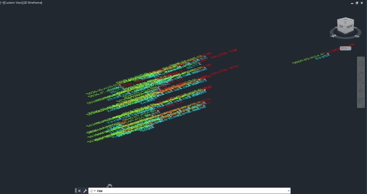

I have exported some survey data from a Leica TS16 into a DXF file with Point ID, E, N & H. The data is imported as points with data labels on various layers.
The points I've measured are displayed in plan view (readable from the top view) and I'd need them to be displayed in elevation (Front view).
Is there a way to rotate the points to display in front view whilst remaining at the same coordinates?

I can change the view to a FRONT view, however, the points and text remain displayed in TOP view and are unreadable

Thanks for your reply, the viewports aren't necessarily the problem I have. I have tried 3dRotating the points and text about the x-axis. This seems to work but the points and text have to be rotated individually. I am likely to be working with hundreds, if not thousands of points so was looking to have a solution to complete this in bulk if possible
Ok understand what you want and a simple answer is to duplicate the text onto a different layer and rotate3d that text. Then you can turn off plan view text and see Front text.
Having worked with 3d points re CIV3D you will still have a mess when it comes to reading the points and text form a front view.
Anyway try this on a few points.
