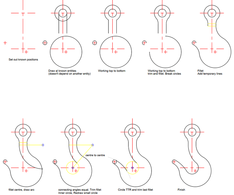

SLW210 Posted August 24, 2023 Share Posted August 24, 2023 I was more or less looking to get the OP to work it out a little more. I can post my tutorial later, maybe tomorrow as there are already solutions posted. 1 Quote Link to comment Share on other sites More sharing options...

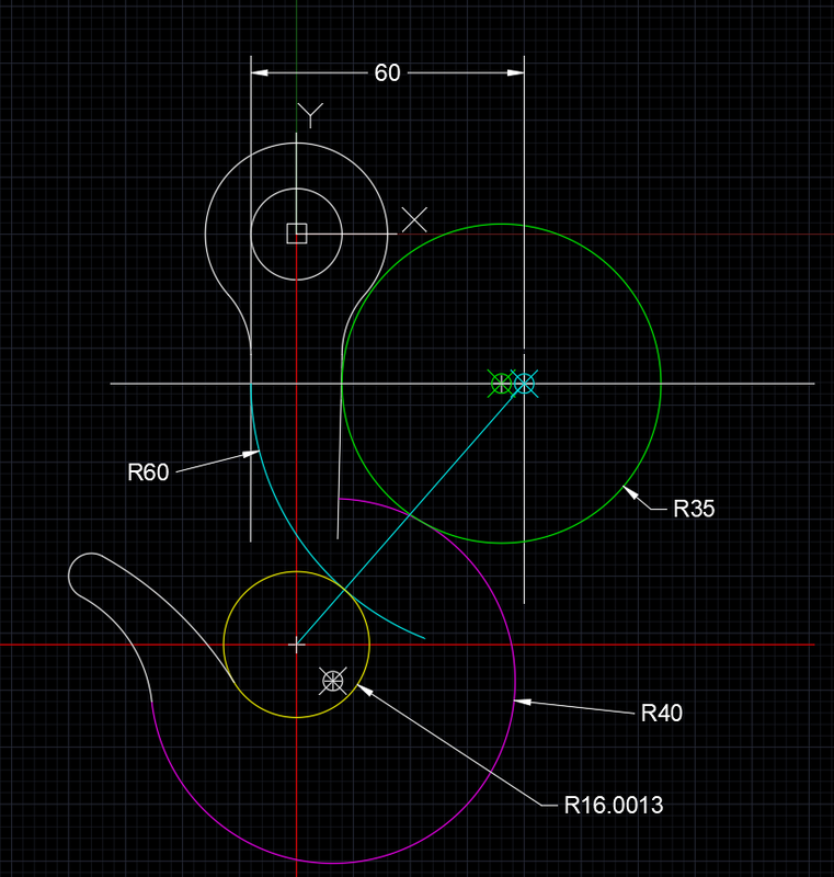

Steven P Posted August 24, 2023 Share Posted August 24, 2023 1 hour ago, SLW210 said: I was more or less looking to get the OP to work it out a little more. I saw that, but there was enough above my post to give the OP the solution they'd originally asked about (the 60 radius curve). Quote Link to comment Share on other sites More sharing options...

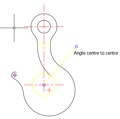

SatoshiQ Posted August 24, 2023 Author Share Posted August 24, 2023 thank you guys so much for all the helpful comments, so I think the point is we assuming the straight part end point have the same level. Quote Link to comment Share on other sites More sharing options...
SLW210 Posted August 25, 2023 Share Posted August 25, 2023 Just using 15 or 16 for the radius of the throat opening of the hook works as well. Were there any written instructions for these tutorials? Quote Link to comment Share on other sites More sharing options...
SatoshiQ Posted August 27, 2023 Author Share Posted August 27, 2023 On 8/25/2023 at 7:43 PM, SLW210 said: Just using 15 or 16 for the radius of the throat opening of the hook works as well. Were there any written instructions for these tutorials? some did have and this one is not yet, there are about more than one thousand excersices there. Quote Link to comment Share on other sites More sharing options...
SLW210 Posted August 28, 2023 Share Posted August 28, 2023 You should look around for another source for some tutorials IMO. I did a quick internet search of AutoCAD 2D exercises and selected images and found plenty that seemed more detailed, even some YouTube tutorials. AutoCAD 2D exercises at DuckDuckGo Quote Link to comment Share on other sites More sharing options...
