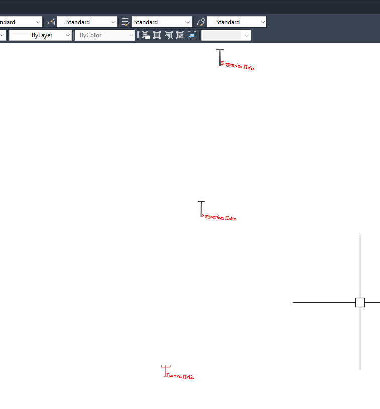

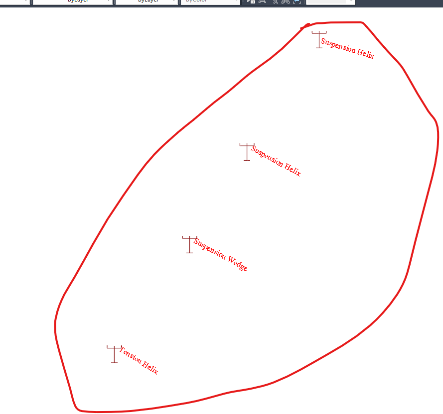

Hi,
can anybody help me actually i have multiple text which i want to move at block insertion point as i am doing it through move command one by one but it take lots of time is any lisp available to move all text to block insertion point
Before
After
