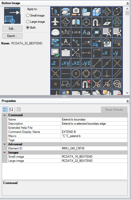

I have created a new icon for my tool palette for Trim by boundary edge.  I did this because the new Trim command automatically trims to the next adjacent boundary edge.  This works great and I wanted to create another extend command that would extend to a selected boundary.
I created the extend command but for some strange reason it repeats the last command when selected.
Here is my CUI screenshot
This does not currenlty work as I planned.
Any help would be appreciated.
Thanks,
Chris
Extend (return)
b(return)
is what would be typed on the command line
Had a quick look at the CUI and I think your answer is ";"
Have a look at other commands for correct syntax.
You need to complete the selection of objects first before entering B for Boundary.
Your macro should work if you preselect the object(s) you want to Extend first.
Note: If you attempt to hit enter to repeat a macro like this only the Extend command will repeat not the B for Boundary.
