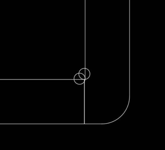

@ ronjonp
Can you please how can i fix this issue?
46 minutes ago, smallƑish said:
@ ronjonp
Not sure? Need a sample drawing. Also .. the code works ( mostly ) with two offset polylines each with 3 vertices if you need something more complex look into the links I've pointed you to.
This works on most angles.
Edited by ronjonp
I got it was my mistake, it's working properly. Thank you so much.
