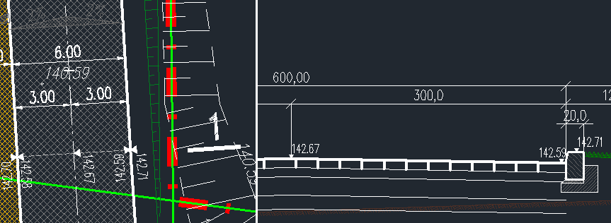

The TextCalcV1-0.lsp program inserts the calculation result in the drawing in the form of the MText object with the current font size (variables-textsize) and style ((variables-textstyle). This causes the inserted Mtext often to be significantly different font size of the objects selected for the calculation and is either much too large or too small.
Can someone change something in the program so that the result is inserted with a font size taken from the object
indicated for calculations?
The calculation objects can be Single-line Text, Multi-line Text, and Dimension, Multileader or Attribute.

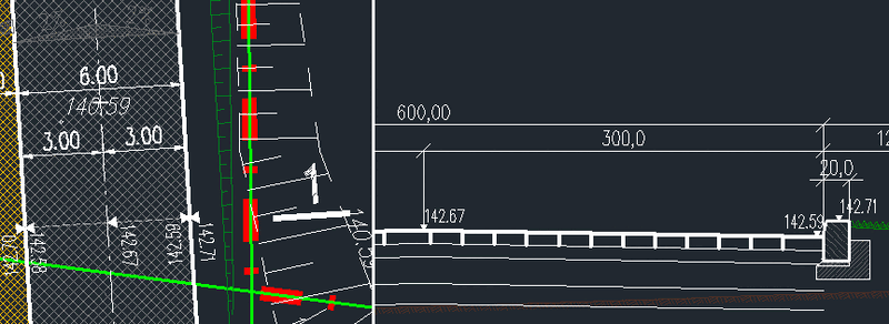

An example is attached.
I usually use two drawing settings in one file. Site plan 1 autocad unit = 1 meter and sections 1 unit = 1 cm. In addition, I often make drawings 1j = 0.5 cm, I also get drawings from other people where the settings are still different.
The point is not to change the font size manually depending on the selected objects for calculations, but the program itself changed the font size by taking its size from the selected object for calculations.

Yup, in the example it looks like he adds mtext result using vla-addmtext which I don't think can have a height variable added - uses whatever system variables are set - set text size before you run the command
It's not about manually setting something before or after the command is executed. I thought that maybe there is a possibility that after indicating the first text object, the program could read the font size from its properties and change the textsize variable to this size before inserting the result. Then the inserted text of the result would be the same size as the selected object for calculations.

I looked at the SetCurrent.lsp and, by analogy, added two lines of code after (setq entity...) to textcalculator.lsp. Thanks to this, the program sets the current font size to the same as the font size of the selected object.
  (defun _Select ( msg / entity num dtext mtext )
    (while
      (progn (setvar 'ERRNO 0)
			(setq entity (car (nentsel msg)))
			(setq entbl (entget entity))
			(setvar "TextSize" (cdr (assoc 40 entbl)))
I hope LeeMac will forgive me.
