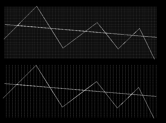

Quite a genius little bit of code.
what its doing getting min and max points of selection set.
Calculating the length and width then dividing the shortest side by 50 to get the increment
starting the boundary command
SPAM CLICKING a grid of points using the increment distance
if the point is fully enclosed by entities it will create a boundary
Stream lined the code to the best of my ability. But where the majority of the slow down is always going to be when the command function is called.
So i made the increment offset for x and y independent. Resulting in a max of 2500 points picked vs the old code of 7007 points picked. (could be more depending on size)
You could also lower the number of division but then you run the risk missing spaces.
uncomment the (vla-addpoint if you want to see the points like above.

Updated to use visual lisp to make boundaries and add to ss2. then run overkill on ss2 to leave unique boundaries. should run faster.
Just had a thought. Will generate all points upfront. then as it creates boundaries delete any points inside. should insure only one boundary is created rather then having to run overkill.
