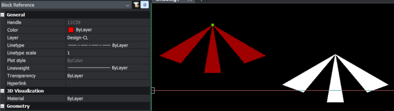

I require assistance. I am changing the colour of several blocks in AutoCAD while keeping the original Architect Colour in the layer properties. I want to preserve the layer settings and only change the item's colour. I've attached a copy of what I'm hoping to accomplish. I would appreciate it if someone could assist me with this matter.

Pdf tells us nothing. Anyway do a bedit on a block and set its color to byblock, obviously set the required color. You may then need to change a existing block property to Byblock rather than Bylayer. White block is byBlock.
Good afternoon, BiGAL,
Thank you responding back to me regarding changing the colour of several blocks in AutoCAD, I can confirmed your information has help me move faster to get the tasks completed.
