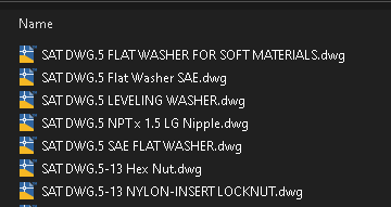

Updated Code to fix minor saving DWG to directory issue and file naming when saving dwg is now the same as the original.  Included some instructions below for anyone that needs them.  All credit to original creators and editors.
To use:  Copy and paste the entire code to a file and save with extension .lsp   for example: conversatfiles.lsp.

-------------------------------------------------------------------------Copy and Paste everything above this line   and save to file -------------- ------------------------------
To use this to convert do the following
Must have AutoCAD installed.
Create a directory for the SAT files to be converted. Copy the SAT files to this directory
Create a directory for the converted DWG files.  The DWG files will be saved here
Usage:
1. Open AutoCAD and create a new blank file
2. Access the command line:
   Enter F2 to get to command line
On the command Line Enter:
APPLOAD
A window will open.  Chooose the converter file name (whatever you named the file) for example convertsatfiles.lsp
Click Load and the message: convertsatfiles.lsp successfully loaded will show.  click Close
On the command line Enter:
sat2dwg  -  A window will open.
Navigate to the source directory and choose this directory (this is where the SAT files are kept) next
Navigate to the target directory and choose (this is where the DWG files will be kept)
conversion processing will begin immediately.  You will see activity happening in the command line window as the files are updated.  It will convert all files in the SAT directory to DWG
Edited by SLW210
Added Code Tags!
I forgot all about fixing this, thanks!
