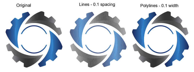

More importantly, I need them as dense color matching lines, so replacing them is just fine.
Solid is fairly straight forward, just replace with a line style hatch scaled to be nearly solid and match the color.
Tougher is matching the gradient hatching to the varying colors the same, my brain is drawing a blank on if that can be easily done.
Main problem is, I need these logos/designs as different vector types and solid and gradient hatches are just left out when importing/converting.
This is a fairly simple example. I currently have to redo them in Illustrator, Inkscape etc. and just have to eyeball match the colors.
I included a sample .dwg and a PNG of the AI Illustrator file I made of one of the logos.

Hi SLW
This one works OK with LINEAR gradients, but for some reason, it doesn't match exactly the Cylindrical ones.
I tried various interpolation methods, but none seems accurate.

Hi SLW
Here is a better approximation of cylindrical gradients.
Don't ask what those numbers are. Long story.
I forgot to tell you, the spherical gradients family is ignored. That would be the challenge...
Also, there is a property of gradient, "Centered", which in your case is always true. If you change it to not centered, the gradient is shifted and that's another story for another day.

That works very well.
I'll check it later on some different logos.
The file size is 1/4 the size of the .ai file. Very nice!!

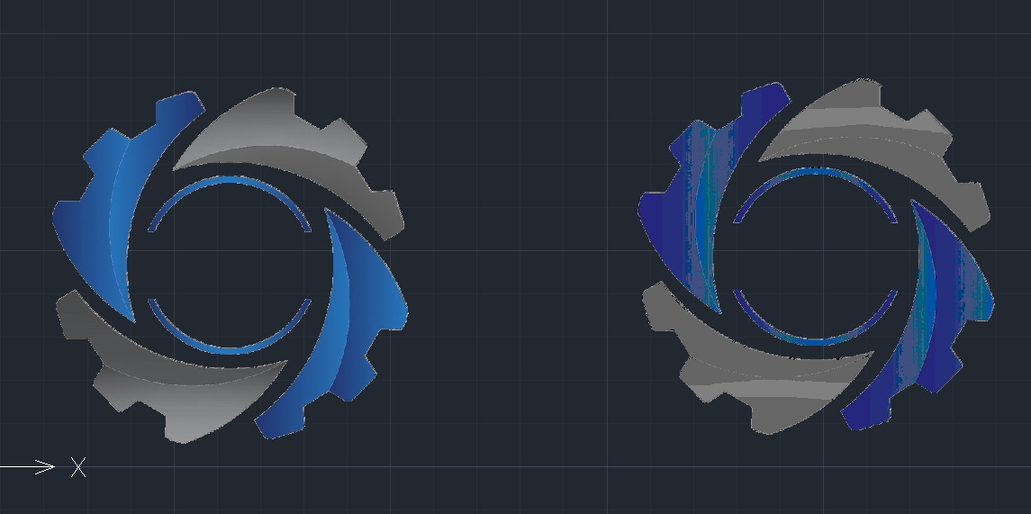

problem has already been solved by the comments above,
but I tried changing png to 24bit bmp in Windows Painter
and using the bmp to polyline routine I wrote before.
(Input 255, 255, 255, 30% in exclusion color, keep true color)
left : true color, right : aci color for ctb
In this case, there is already a gradient hatch on the CAD
so there is no need to perform this additional process.
but this routine can be applied to any image and it doesn't matter what shape it is

This instance was to convert vector files with gradient hatches.
I'll try it, I do sometimes need to get image files to vector.
Exactly what I had to do for the example here was, I got the logos approved, but what ever company (companies) they were using couldn't use a .dwg or image files, they needed .svg or .ai or similar. The .dwg and several image types all didn't look very accurate when converted to vector in Illustrator, I ended up printing to PDF, importing the PDF into Illustrator and it only needed a little extra work. This example is just a portion of the entire logo. The .svg was too large to email so they used the .ai, AFAIK it worked okay, though.

These both are working pretty well.
It may be a while before I can test the results of outputs to .ai, .svg, etc. fully, but so far they seem sufficient for my purposes, until someone moves the goal posts on me.
