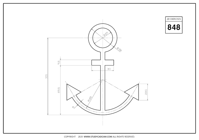

SatoshiQ Posted August 9, 2023 Share Posted August 9, 2023 I think it lack of information, am I wrong? Quote Link to comment Share on other sites More sharing options...
BIGAL Posted August 9, 2023 Share Posted August 9, 2023 Only the anchor arrow heads appear to be missing an angle I would use 45 for the base lines of the arrow compared to the vertical. Quote Link to comment Share on other sites More sharing options...
SatoshiQ Posted August 9, 2023 Author Share Posted August 9, 2023 but I don't know the angle or dimension to start drawing the anchor. Quote Link to comment Share on other sites More sharing options...
eldon Posted August 9, 2023 Share Posted August 9, 2023 This is maybe an exercise to see one copes with missing information. Looking at the diagram, it is not vital what the angle is, so one could estimate it - depending how good your eye is. Or you could take a screen snip, insert it into a drawing and trace off the angle, as in the picture below. Otherwise there is ample information to draw the exercise - just start by drawing the lines that are dimensioned and you will soon have the whole thing drawn. 1 Quote Link to comment Share on other sites More sharing options...
SatoshiQ Posted August 9, 2023 Author Share Posted August 9, 2023 thank you. Quote Link to comment Share on other sites More sharing options...
CyberAngel Posted August 9, 2023 Share Posted August 9, 2023 There is only one dimension for the arrow heads, but I think that's enough to let you establish the others. Don't forget to use mirror so you won't go through the same process all over again on the other side. Quote Link to comment Share on other sites More sharing options...
