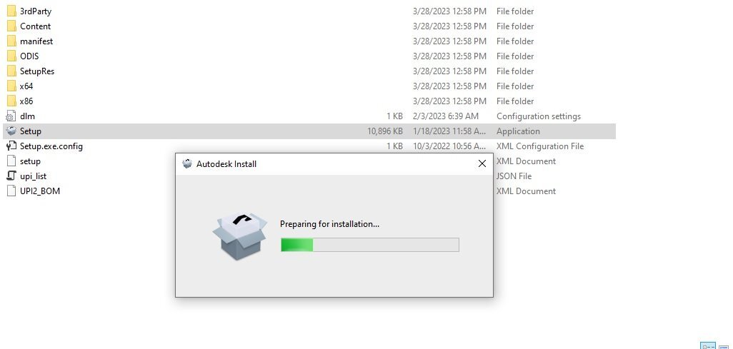

Hi everyone,
When I install AutoCAD 2024, open "Preparing for installation..." and after 10-15 seconds, close that window and don't go in main setup window.
How can I fix this problem?
Best regards.
I needed Autodesk Access which replaced the old desktop app for installing 2024. Install it and the AutoCAD 2024 installation was fast and simple.
Same here, you need Autodesk Access everywhere now to get downloads, updates, etc.

I found the fix for this issue. Suprisingly when you try to install the product offline (running the setup.exe without and internet connection) the window doesnt disappear and actually installs. However for deployment you will need the an internet connection, this got me thinking that the installation process does try to reach out to the servers to check for any new versions available.
The parameters to use for cmd or deployment is setup.exe --noupdate -q (q is for the silent install)
