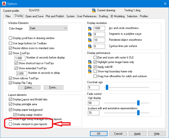

Struggling with the viewport, I am unable to get the drawing from the model space to appear in the paper space, when I double click in the viewport it does not show the drawing from the model. I am sur it is just a setting, but not sure which one it is, any help is greatly appreciated.
Did you try Zoom Extents? Did you check to see if the layers are frozen in the viewport? Can you post the drawing?

Sorry for the delay, please see attached file. The layout / paperspace is not functioning at all, I can only think its a setting somewhere.

When you go into paperspace are you typing MVIEW and then selecting amongst other things FIT ?
This will then (hopefully) give you your drawing inside the newly created viewport.

When you open paper space, there is only a dashed-line frame. This means that you have not created a viewport. Until you do, you will not see anything.
If only you had posted a drawing in the beginning, you would have had an answer then instead of everyone guessing. Still. it gives brains a workout!
I had a pretty good idea that was the issue.
Most are used to the default "Create viewport in new layout"
