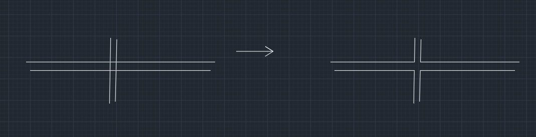

help me create a lisp that can intersect segments if it is polyline, line,mline,spl...
CAB's BreakObjects23.LSP Comes to mind. Then select lines <= the space and delete.
I have a similar lisp but it doesn't cut the way I want
Edited by Hải_Duy
His works like this. trust me you want CAB's
c:BreakWith -     Break selected objects (green) with other selected objects (blue)
So Selecting the green lines first then the blue lines. it would break the green ones where blue intersected them. then then just delete the (red for refrence)  giving you the effect you want.
Edited by mhupp
thanks bro, I just found the BreakObjects23.LSP lisp
Used Cab's code to make cross line clean ups. I added a look for short length lines and delete after breaking.
