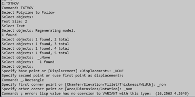

Thanks for your response, I have the following error.
My bad that's what i get for working in notepad!

Command: TXTMOV
Select Polyline to Follow
Select objects:
Text Size: 2
Select Text
Select objects: Regenerating model.
1 found
Select objects: 1 found, 2 total
Select objects: 1 found, 3 total
Select objects: 1 found, 4 total
Select objects: 1 found, 5 total
Select objects:  _.Move
Select objects:
Specify base point or [Displacement] <Displacement>: _NONE
Specify second point or <use first point as displacement>:
Command: _.Rectangle
Specify first corner point or [Chamfer/Elevation/Fillet/Thickness/Width]: _non
Specify other corner point or [Area/Dimensions/Rotation]: _non
Command: ; error: lisp value has no coercion to VARIANT with this type:  (16.2563 4.2643)
Thanks for your help. Still has some errors to solve
Edited by CADWORKER
Someone with AutoCAD is going to have to trouble shoot it because its working on this end in BricsCAD.
