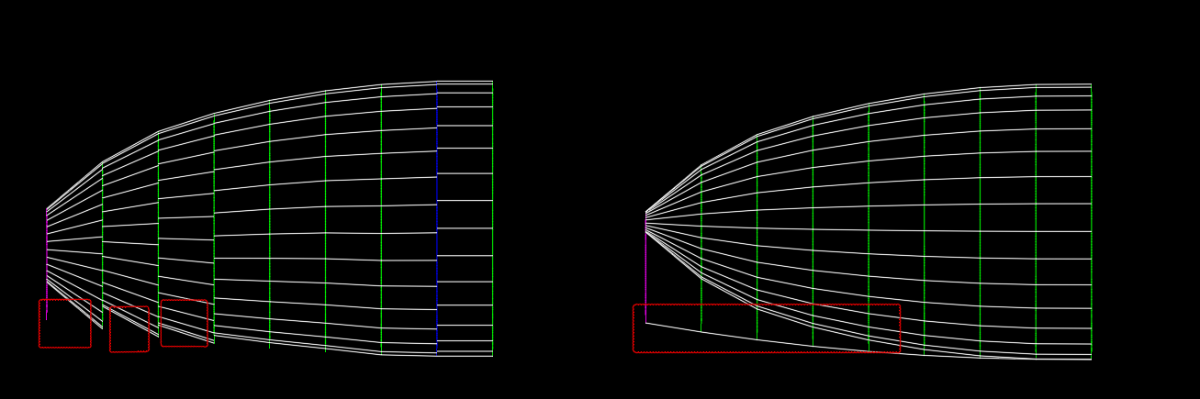

Hi all,When I run the command path array over the elliptical curve it doesn't fully run over the curve as i clouded in the below attached image.I also attached dwg file.Can anyone please suggest me some ideas to run the line over the elliptical curve at a distance of 600mm between the lines and it should cover the full ellpitical path?
Purlin Arrangement.dwgFetching info...
Have you looked at Revsurf ? Can set the number of faces.
