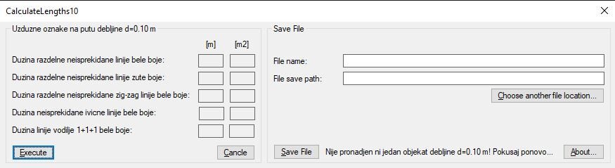

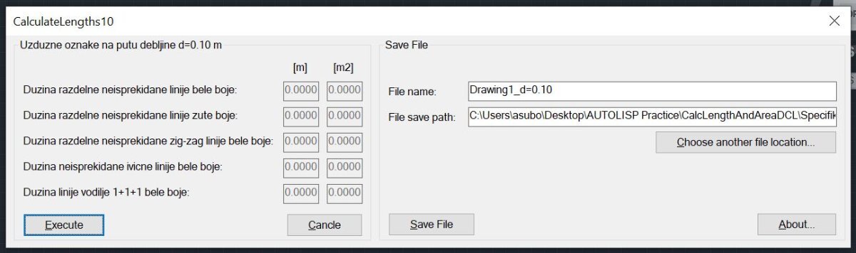

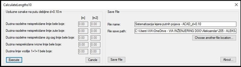

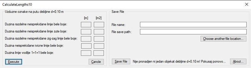

Hello everyone,
I'm the new one in autolisp programming, and i'm trying to link lisp file with dcl file. In my lisp file and dcl file i'm trying to develop an application where after pressing "Execute" button, the main dialog is hidden, then start processing code inside the "Execute" button where prompt to user to select object's in drawing to proceed calculation of lengths of line, polylines, lwpolylines, etc.
The main problem i have and don't know how to do that/solve is: when using (setq ss (ssget '((-4 . "<or") (0 . "INSERT,POLYLINE,LWPOLYLINE,LINE,ARC,SPLINE") (-4 . "or>")))), where before that is prompted to user to "Select linear object's for calculating total lengths", and after selecting in model space where the variable "ss" is "nil" (there is no selected object's) the main dialog is returned (with basic setup which are shown in dialog when first time started) instend of "error: bad argument type: lselsetp nil" and abort/exit from dialog. This functionallity will be helpful to prevent everytime abort/exit an app (if there is no selected object's), instend of again calling in AutoCAD command for starting lsp file to load dialog and the rest. Also, i want to tnx to AfraLISP who provide a topic with "Hiding Dialog Boxes" which are really helpful for me (and maybe to update topic or create a new on if there solution for that which i described in)! I will post a lsp and dcl file which i writte using notepad++.
*CalculateLengths10 lsp file below.

	 (setq path (findfile (strcat ".\\" def_name)))
	 (setq dialogshow T)
	 (setq dcl_id (load_dialog "CalculateLengthsAndArea.dcl"))
	 (while (> flag 2)
		 (if (not (new_dialog "CalculateLengths10" dcl_id))
				(setq dialogshow nil)
	 (action_tile "execute" "(done_dialog flag)")
	 (action_tile "cancle" "(cancle)")
	 (action_tile "about" "(about)")
	 (action_tile "save_file" "(save)")
	 (action_tile "choose_location" "(choose_location)")
	 (set_tile "name1_m" (rtos sum_name1))
	 (set_tile "name1_m2" (rtos sum_name1_m2))
	 (set_tile "name2_m" (rtos sum_name2))
	 (set_tile "name2_m2" (rtos sum_name2_m2))
	 (set_tile "name3_m" (rtos sum_name3))
	 (set_tile "name3_m2" (rtos sum_name3_m2))
	 (set_tile "name4_m" (rtos sum_name4))
	 (set_tile "name4_m2" (rtos sum_name4_m2))
	 (set_tile "name5_m" (rtos sum_name5))
	 (set_tile "name5_m2" (rtos sum_name5_m2))
	 (set_tile "file_name" spec_name)
	 (set_tile "file_save_path" path)
	 (setq flag (start_dialog))
	 ;; prilikom klika na dugme "Execute" u DCL-u poziva se funkcija (execute)
	 (execute)
	(unload_dialog dcl_id)

(defun execute ()
		(if (= flag 4)
				(prompt "Selektujte linijske objekte za proracun ukupne duzine") (princ)
				(terpri)
				(if (= ss nil)
						;;(new_dialog "CalculateLengths10" dcl_id)
						(set_tile "error" "Nije pronadjen ni jedan objekat debljine d=0.10 m!")
						;;(start_dialog)
				(setq len (sslength ss))

Thank you to everyone who takes the time to read this text and help solve the problem.

Thank you mhupp on nice words (I appreciate it). Well, i'm using ChatGPT to help me in searching for the solutions, because sometimes searching for solution on google, forums, ect. can be painfull (it takes a lot of time to find it). Sometimes in ChatGPT on the posted question i get solution, sometimes don't, like for this topic which i post it. The whole logic, def val, especially naming of variables, comments, ect. is mine, and it helps me to easy manipulate in writing the code, finding in code, changing and much more (i love everything to be organized, i'm stubborn as mule 😅).
Somehow, when i post the lisp code, it didn't paste (or i miss it in selecting) the part after "prompt" and before (if (== ss nil)...) whic is: (setq ss (ssget '((-4 . "<or") (0 . "INSERT,POLYLINE,LWPOLYLINE,LINE,ARC,SPLINE") (-4 . "or>")))).
The Selection button will be works like Execute button (like now), when it pressed, first prompt user to select objects, then calculate length for the layers who have a predefined names (from 1 to 5), and then retrieve the length in [m] and [m2] in the main dialog (when i test it, it works perfectly). The only thing i want is to prevent exit/aborting from selection set if there is not an objects in layers who have predefined names (from 1 to 5), like nil.
Once again, thank you! 😀 I will try with

It works, thank you mhupp and BIGAL for responding and help me in finding solution! I do the little update of execute button, and it looks:
