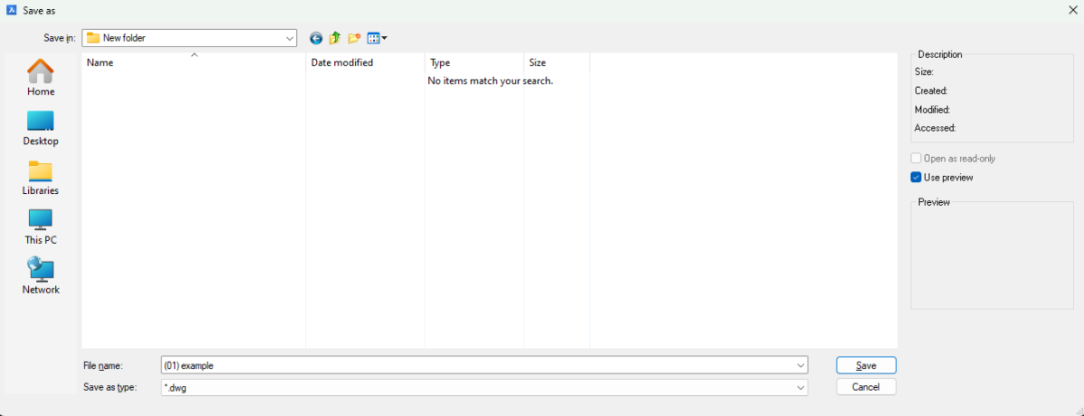

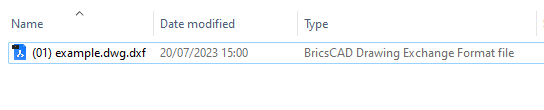

I don't know why, when I try to use that lisp, I'm not be able to change the extension. A window appears asking me to save in some location, I choose and put a name, see below:
But when it's save, always is as .DXF extension.
Any ideas?
