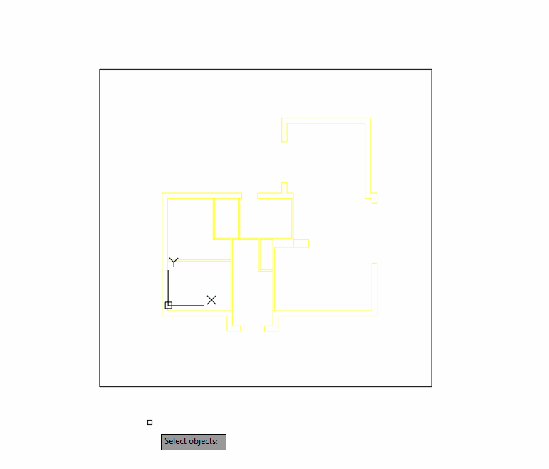

Draw vertical XLINEs from picked points to closets point in the Y direction
3dwannab
See the image below. It shows the red line that represents a pick point of pt1 and pt2 along the X-axis.
I was hoping to then draw a vertical line through the closest vertices of polylines in the Y axis.
See the image before for an explanation of how I think it would work. 1-6 are where the XLINES would go through.
See also the cad file to show the final result.
is there anything like this out there?
Example of Finished Command (Xlines In Blue).dwg
A try with this which works with your example
For baselines located in the east, west or north, the code must be improved...

I took over the code to be able to make requests (in a loop) from lines located in the East, North and West.
But I changed the type from XLINE to RAY which leaves the reading clearer.
If it can help you...

@Tsuky, I can't thank you enough this is just amazing 🤩
Something I never thought I wanted until the other day but such a game-changer. The find_inter  is great.

Hi @3dwannab
It's simply a property story filtered into the selections.
We have the expressions:
'((0. "LWPOLYLINE") (67. 0) (8. "TS_wall"))
in the code.
Which filters the "LWPOLYLINE" objects located in the "Model" space and in the "TS_wall" layer
In your drawing you do not have the "TS_wall" layer, so no selection.
What to do?
Either create the layer in the drawing and change the layer objects...The code will work.
Either modify the filter in the code for your drawing (twice in the code)
'((0. "LWPOLYLINE") (67. 0) (8. "0"))
And more risky (risk of selection on all layers), delete the layer name property.
'((0 . "LWPOLYLINE") (67 . 0))
