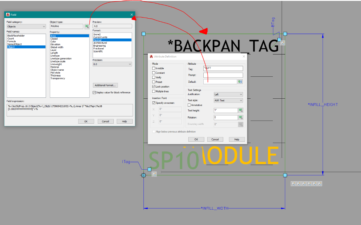

Trying to extract sqft of a dynamic block to an attribute for data extraction, attribute eventually breaks showing #### instead
Hello! I have been running into some issues with my dynamic blocks I have created for my works infill block library and I am beyond stumped as to how to find a stable workaround.
Running AutoCAD 2022
So I want to create an easy way for the Sq Ft of our infill blocks to be extracted via data extraction. In each of our infills I made an invisible attribute labeled *SQFT and have them pulling the area of the polyline that will represent our daylight opening. This seems to work for a while, but the issue is once these blocks get copy pasted throughout our elevation drawings I keep finding that instead of the square footage being displayed it instead reads ####.
We have found a workaround for now which is to rename the *SQFT attribute to a different name, sync the attribute, then change it back.
I hate that this attribute keeps breaking, and I usually just pull the height and width parameters and manually calculate the sqft that way in excel, but my team doesn't like doing that.
Is there a more effective way I can pull the SqFt of my blocks without needing to fix this issue all the time?
This is how I am creating the *SQFT attribute for each of the infills

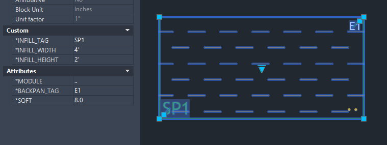

*SQFT tag is updating correctly to display the polyline's area after a refresh, the issue is this method will seemingly break randomly and instead display ####
XXXX-Q400 E.dwg

For me a different approach I read the block properties in to a dcl so setting the 2 x 4 etc by inserting the block 1st then resetting the properties and setting the attribute sqft. Maybe a custom dcl as it has a mixture of dynamic properties and attributes.
The input can be done as a 5 getvals sqft is not inputed.
(if (not AH:getvalsm)(load "Multi Getvals.lsp"))
(setq ans (AH:getvalsm (list "Enter Values" "*INFILL_TAG" 5 4 "SP1" "*INFILL_WIDTH" 5 4 "4" "*INFILL_HEIGHT" 5 4 "2" "*MODULE" 5 4 "" " *BACKPAN_TAG" 5 4 "E1")))
Multi GETVALS.lsp
You need Lee-mac Dynamic block properties lisp as well for setting the block properties.
