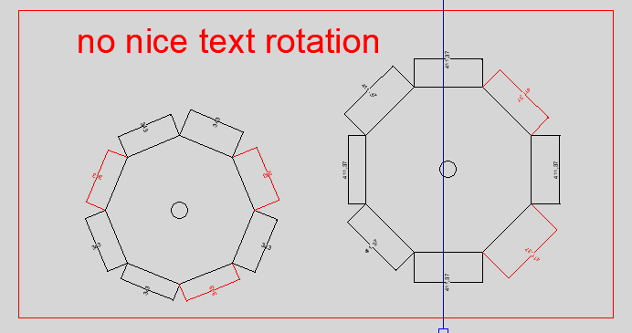

I use a function such as the following -
;; Readable  -  Lee Mac
;; Returns an angle corrected for text readability.
(defun LM:readable ( a )
    (   (lambda ( a )
            (if (< a 0.0)
                (LM:readable a)
                (if (and (< (* pi 0.5) a) (<= a (* pi 1.5)))
                    (LM:readable (+ a pi))
                    a
        (rem (+ a pi pi) (+ pi pi))

@Lee Mac despite I use the word READABLE at my post , I did not use it at your web site. Thanks for it.
Lee , please put it as a lsp at your website , loking for
LM:readable
do not give result.
I will apply it to my LISP.
Best regards
