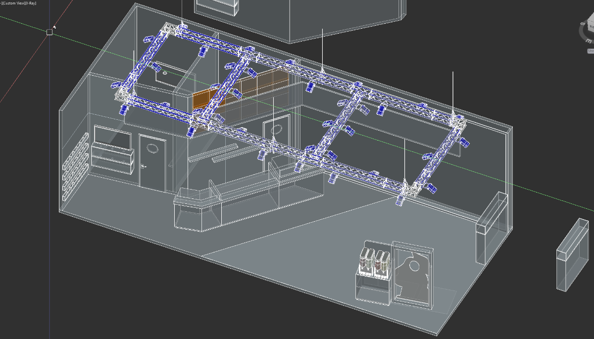

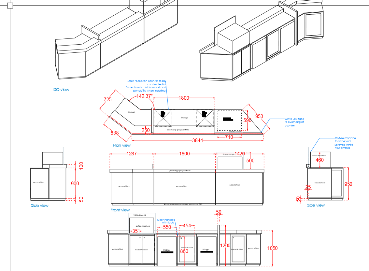

Hi Guys, thanks for such a quick repsonse and explaination. Yes i agree its one of those process that i need to master but it will take a while as i'm at the point where i can confidentely model all the detail i want but i'm having issues conveying the detail in paper space without it massivly slowing down my process.
I have attached a couple of screen shots to show my 3d model in model space then how i current take flatshots of the 3d model in model space and then view the 2d lines from paper space.
So all my current annotations and dims etc are in model space and i just use paper space for a view but i would like to migrate so all my dims and text are scales to paper space and i just can punch into the model and grab views if that makes sense?
As my drawing tend to have several components i was cautious of hiding a counter for example to islote it and then it disappearing on another page as a full drawing pack tends to have around 10 layout pages.

Looks like drawing the counters in model space and annotating them in paperspace - adding the notes and dimensions - is the way to go
Dimensions in model space should give you the correct size if you put each end on a model space object, and of course you can add notes as you want in paperspace too. I would lock the viewports once you have them displaying as you want - adds a little protection from things moving about on the screen and loosing the associated texts.
Looks like you are going the right way with this, draw 3d model an make views in viewport. Ali I'll say is try it and see - which is lucky, Friday afternoons are never productive anyway..... (I knew of a company that gave their employees every Friday afternoon as 'self improvement' time - things like this that you don't get time during the week to just try it and see what happens)
