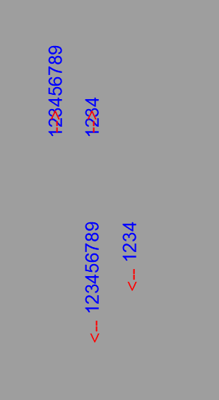

I wrote this Lisp Script to place an arrow text next to selected texts

NEWP_L and NEWP_R are the Location where the arrow should be placed depending on the Text Justification of the selected text
The Insertion Point of the text with Justification Right is correct. But the with Justification Left it just uses the same point as the selected text
In the Attached Screenshot, you can see Example 4 is correct and Example 3 it uses the Insert point of the Selected Text (Example 3) instead of NEWP_L
I checked the Variable NEWP_L and the Coordinates are correct. The _-TEXT Command just does not seem to use it
I can not test your program right now, but there is an AutoLisp function called TEXTBOX that returns the boundings of a text/mtext entity. Maybe that could help you?

; error: AutoCAD variable setting rejected: "CLAYER" "Layer"
1 hour ago, SLW210 said:
I get an error running the code.
You probably don't have layer called "Layer", I'm guessing
But I don't understand what exactly should be result of this code, I can't figure out from the photo.
I think you should just check text group code 72, test how its justified and then determine insertion point of arrow.
Here you can see the codes: http://docs.autodesk.com/ACD/2014/ENU/index.html?url=files/GUID-62E5383D-8A14-47B4-BFC4-35824CAE8363.htm,topicNumber=d30e678406
Edit: here is some quick code, when you select text if its left justify it creates arrow on left that is right justified to point from left to text, if you choose right justified text it creates arrow from right that is justified left to point from right side to text. Depending on what you need you can modify that simple code, if I understood the problem correctly here.
(setq text (car (entsel)))
(setq textJust (cdr (assoc 72 (entget text))))
(cond ((= textJust 0);left
       (setq insertpt (cdr (assoc 10 (entget text))))
       (command "_TEXT" "j" "R" insertpt 1 0 "-->")
      ((= textJust 2);right
       (setq insertpt (cdr (assoc 11 (entget text))))
       (command "_TEXT" "j" "L" insertpt 1 0 "<--")
