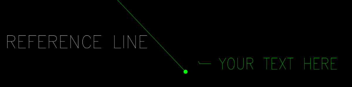

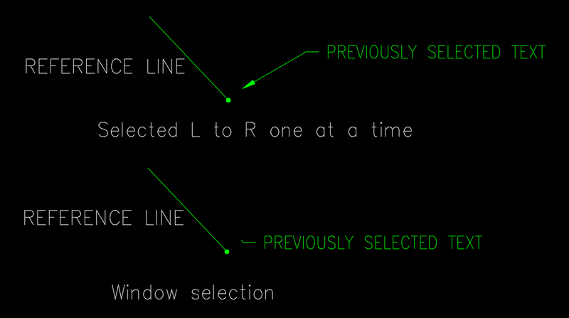

The routine above "works" partially
Original text objects (the text is TEXT not MTEXT
After the routine

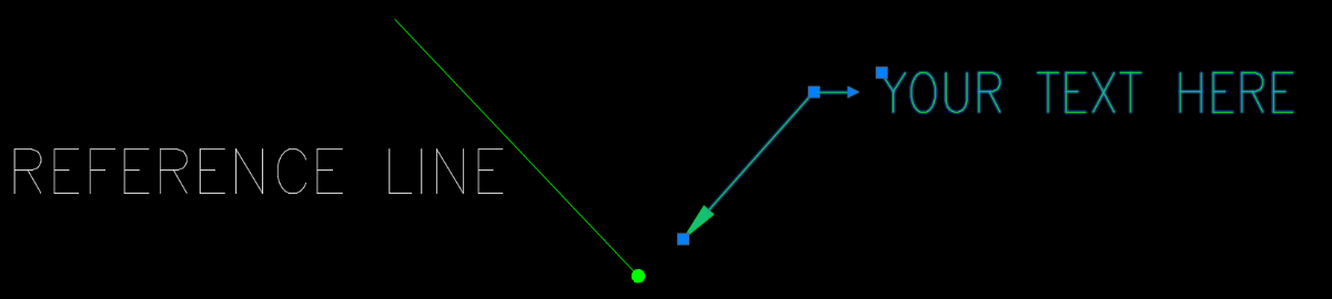

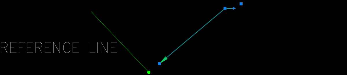

After dragging the end of the leader out
The leader start point moves.

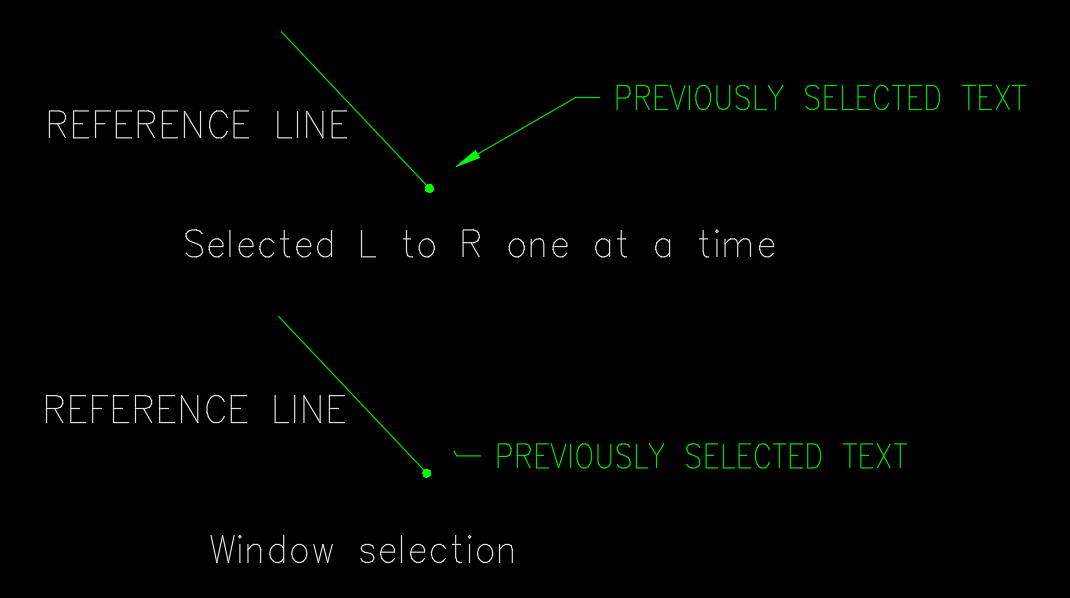

In my testing, the value of the text is very often changed to a previously selected text string too..
I changed the first line
(defun c:L2ml ( / ss acount MyEnt GetEnt EntType MyText Knee LineAngle)
and got this result (IF) I selected the objects one at a time L to R
A selection window gets me this result

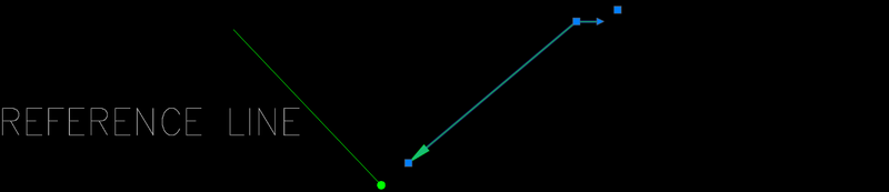

When I drag that leader out I get this result

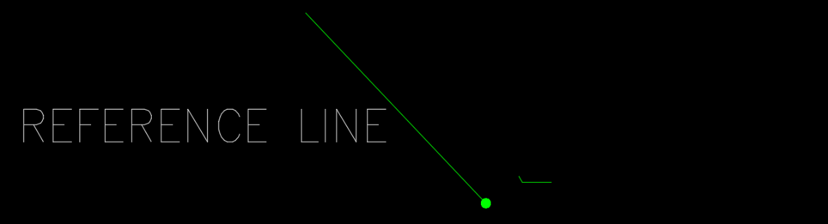

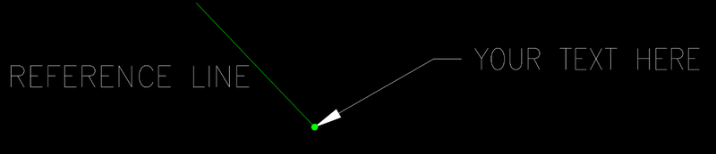

Changing the first line to this
(defun c:L2ml ()
image.thumb.png.3b1cd57818022d6a8d519fb0b0e2ae00.pnge

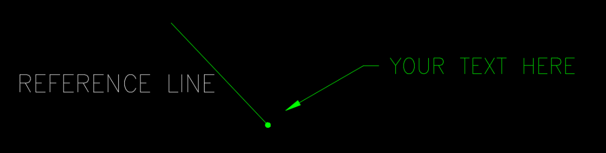

If I convert the TEXT to MTEXT first then select one at a time I get the best result
If I change these lines
 ((= EntType "TEXT")
and select one at a time I get this result
I'll have a look and see what I did wrong,
This change allows it to work on both
