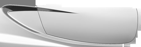

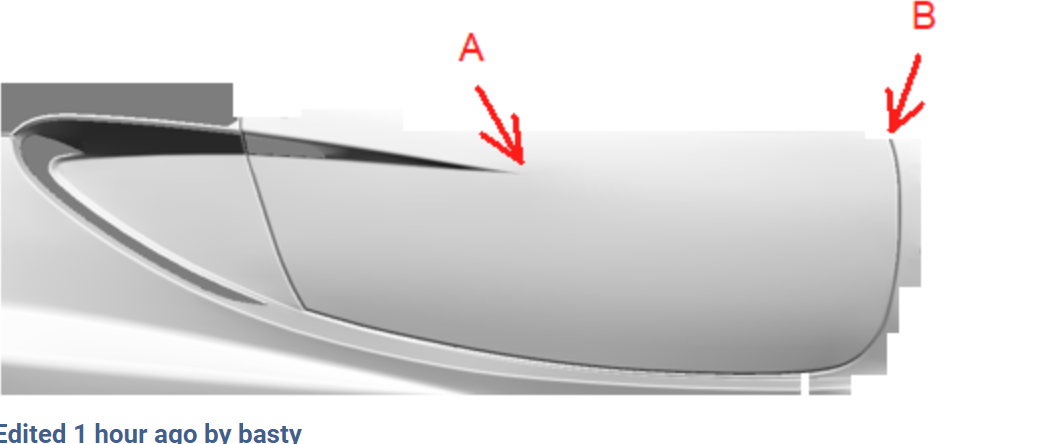

basty Posted July 4, 2023 Posted July 4, 2023 Does anyone know how to draw this curve exactly similar like the picture in AutoCAD only by reference (in this case is a picture) by using Spline command. Thank you Quote
BIGAL Posted July 4, 2023 Posted July 4, 2023 Ellipse ? Looks like a Nurb curve, add more points to a pline then fit or spline. Quote
basty Posted July 5, 2023 Author Posted July 5, 2023 (edited) Why do you say ellipse? It doesn't look like an ellipse to me. Or maybe you're telling me something that I don't know yet. Please explain why do you say ellipse. What is pline? What is the difference between pline and spline? Edited July 5, 2023 by basty Quote

lrm Posted July 5, 2023 Posted July 5, 2023 There are several curves in the picture. Which curve are you trying to create? I assume that you want the curve in 3D. Yes? If so, you will need more information. For example, at least two orthographic views showing the curve. Quote
CyberAngel Posted July 5, 2023 Posted July 5, 2023 If I had to reproduce a set of curves like that from a picture, I'd attach the image as an external reference. That way I could place my control points and adjust them in real time, instead of having to export, check, adjust, repeat. With 3D, of course, you're talking about another layer of complexity. As BigAl says, you may want a NURBS curve. Which is really just a fancy spline. Quote

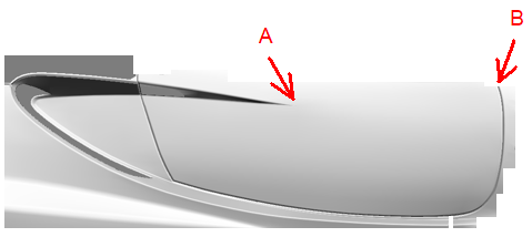

basty Posted July 5, 2023 Author Posted July 5, 2023 (edited) 1 hour ago, lrm said: There are several curves in the picture. Which curve are you trying to create? I assume that you want the curve in 3D. Yes? If so, you will need more information. For example, at least two orthographic views showing the curve. I need to draw all of them, start from A and end to B (please see attached image). Or you can start from B and end to A. If you can't provide me answer with all curves shown in the image, just show me how to construct/draw the inner curve. For now, I just need it in 2D. I don't know what 3D curve is but yes I would like to know how to draw/construct 3D curve you had meant after I get to know how to draw/construct the curve in 2D. Edited July 5, 2023 by basty Quote

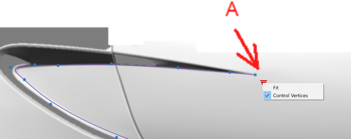

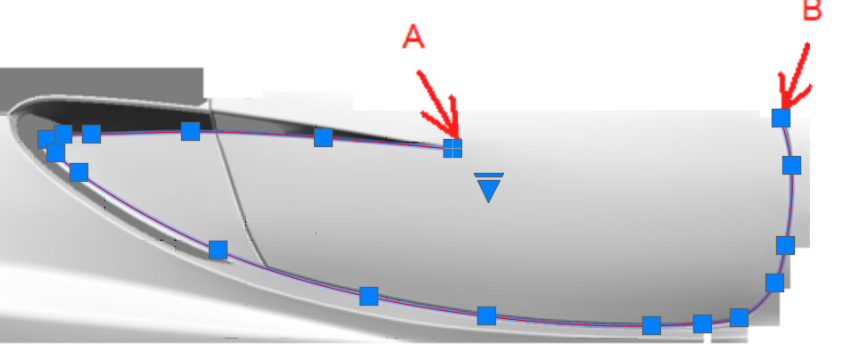

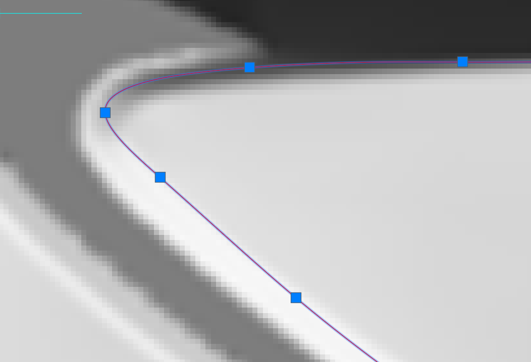

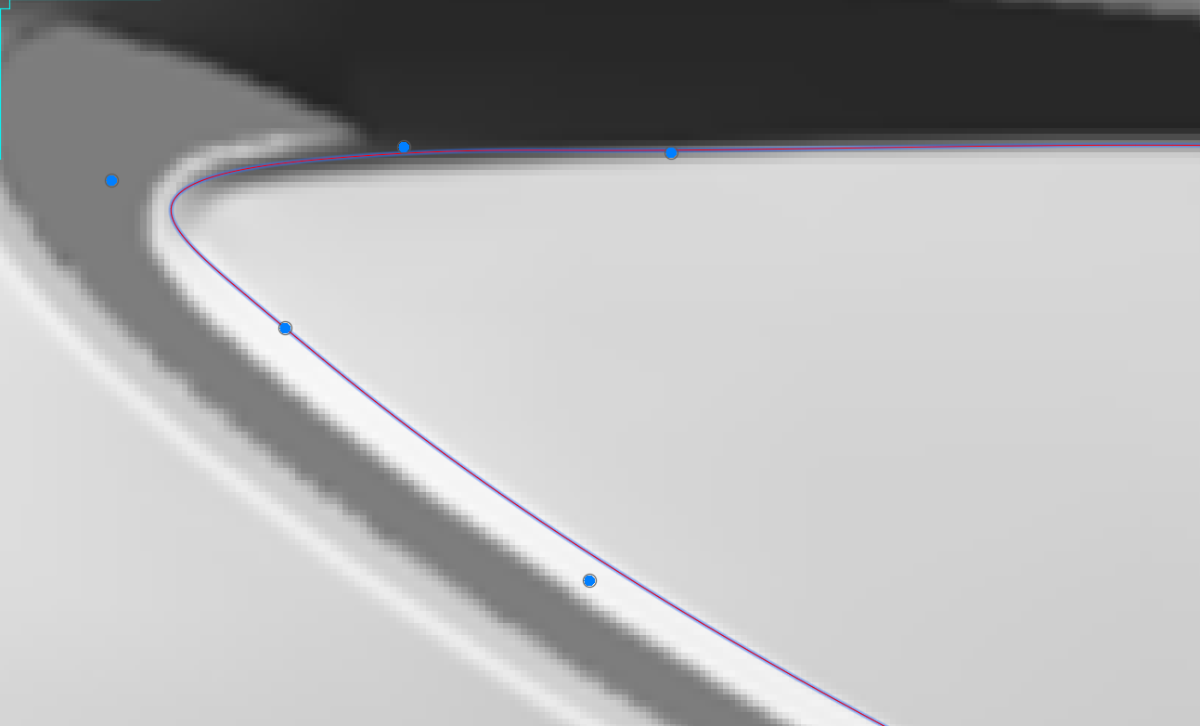

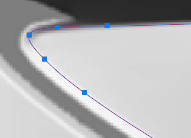

lrm Posted July 5, 2023 Posted July 5, 2023 Start by placing a copy of the image into AutoCAD and scale it to the correct size and lock its layer. Using the spline command create a curve using the fit points method. In general you should use as few fit points as possible and you may need more fit point where the curvature has a smaller radius. Here's my first attempt. Not the location of the fit points. The curve needs some editing in this area. You may not be able to get the desired curve by just moving fit points. For example: Select the spline and pick the Control Vertices method for editing Experiment with moving the CVs. If you need more local editing of the curve use the SPLINEDIT command to add additional CVs. 1 Quote
basty Posted July 5, 2023 Author Posted July 5, 2023 There are 18 points available. How do you know there are 18 points and how do you know the position of these points? If you change the position of these 18 points then the curve shape will be different. Is it by trial and error method? Quote
lrm Posted July 5, 2023 Posted July 5, 2023 I eyeballed the location of the fit points and the spacing was done a bit by experience. Yes, there's some trial and error involved. 1 Quote
