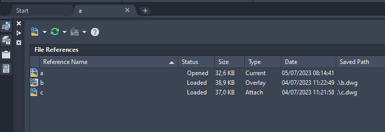

I made "a.dwg", "b.dwg", "c.dwg", "d.dwg"
"b.dwg" has 2 xrefs attached: "c.dwg" as attached xref, and "d.dwg" as overlay XREF.
Now on "a.dwg" I attach "b.dwg"
"c.dwg" will appear in the XREFS in "a.dwg", "d.dwg" will not.  THat's exactly what ATTACH/OVERLAY is intended for.
So, what my scrip here below does, is list the XREFS as they are listed in the XREFS pane.  Are you happy with this?
Anything more you want with this?
