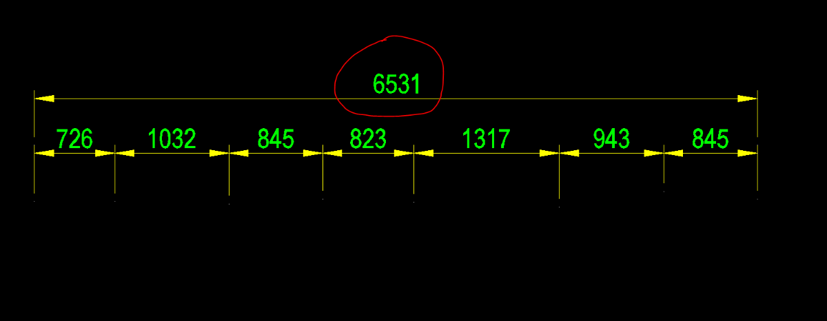

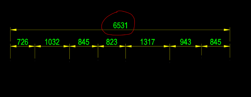

I wonder if the following can be done.
create a dimension with dimlinear,
after execute dimcontinue
and size "n" number of objects
press enter or right button or escape
and create a dimension that is the sum of those individual dimensions.
separated a given distance.
greetings
You can switch off the CMDECHO system variable if the history of the command calls bothers you then reset it back to its original value, so here my initial attempt in this regard.
(defun c:Test (/ 1pt 2pt 3pt hgt ang pt1)
  ;;	Author : Tharwat Al Choufi			;;
  ;; website: https://autolispprograms.wordpress.com	;;
  (and (setq 1pt (getpoint "\nSpecify first extension line origin : "))
       (setq 2pt (getpoint "\nSpecify second extension line origin : " 1pt))
       (vl-cmdf "_.DIMLINEAR" "_non" 1pt "_non" 2pt "\\")
       (setq 3pt (getvar 'LASTPOINT)
             hgt (distance 2pt 3pt)
             ang (angle 2pt 3pt)
             pt1 1pt
         (while (setq 1pt (getpoint "\nSpecify next extension line origin < enter = exit safely> : " 2pt))
           (vl-cmdf "_.DIMLINEAR" "_non" 2pt "_non" 1pt "_non" 3pt)
           (setq 2pt 1pt)
         (vl-cmdf "_.DIMLINEAR" "_non" pt1 "_non" 2pt "_non" (polar 3pt ang hgt))
I like it, I will study it... thanks :)
Using lisp, I think a more what it is your Dimming would be helpful as you can do select multiple say lines and dimension and also do the overall with a lisp. Post a dwg.
Another way is to select all dims and get a start and end point to use.
Another is pick, pick points and remember the pick points use 1st and last point, maybe the easiest way.
