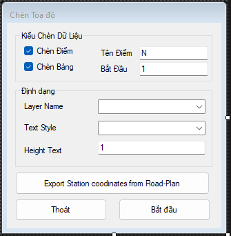

Convert lisp coordinates to vb.net language
I have collected a lisp that allows to pick coordinate points on Autocad drawings. Is there any way to convert the above lisp to vb.net language.
About the interface I designed the form as follows
